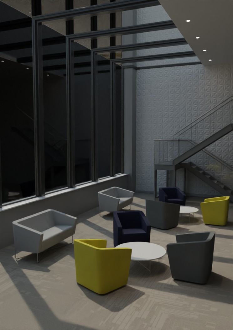

With Photon GI cache only:

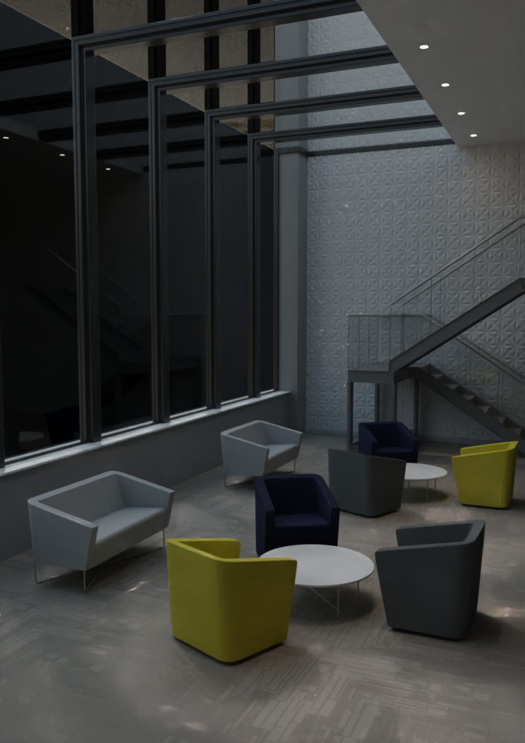

With Environment Cache only:
The expected result, is coming from Photon GI cache image.
I don´t know why Environment cache is "disabling" HDR sunlight.
