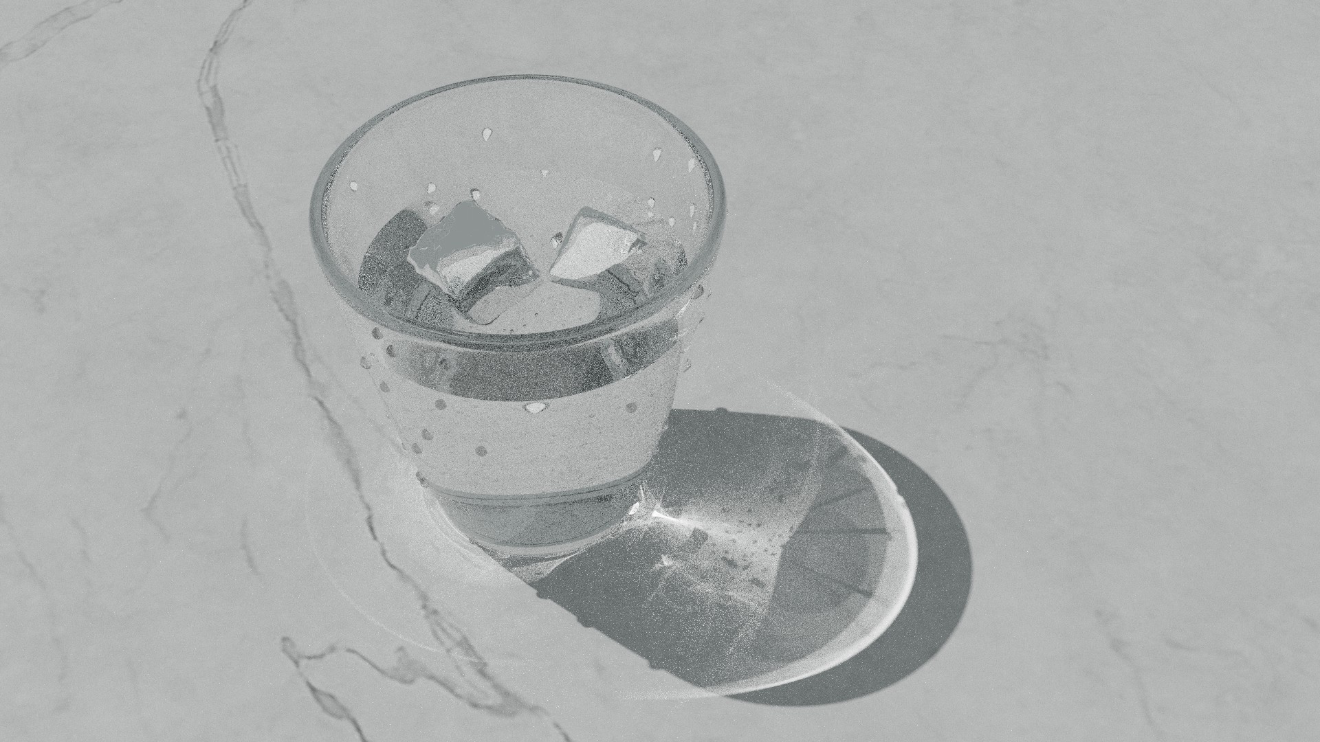

I would recommend to re-create your glass and liquid materials using LuxCore nodes, because you will need to use the volume priority setting to handle the overlapping glass and liquid correctly. I have done that in the attached .blend file. (also, Cycles procedural textures are not supported in LuxCore)
Skilled420 wrote: Wed Nov 04, 2020 2:38 pm How do I also get rid of the black parts of the glass?
You need to raise the max. path depth:
path depth = 20
path depth = 20
path depth = 40
path depth = 40

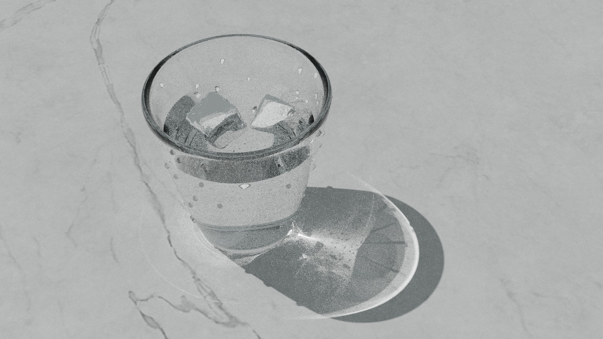

How would I create something that looks like this:Image
Re: Rendering
A nice tutorial theme :idea: will think about it.
