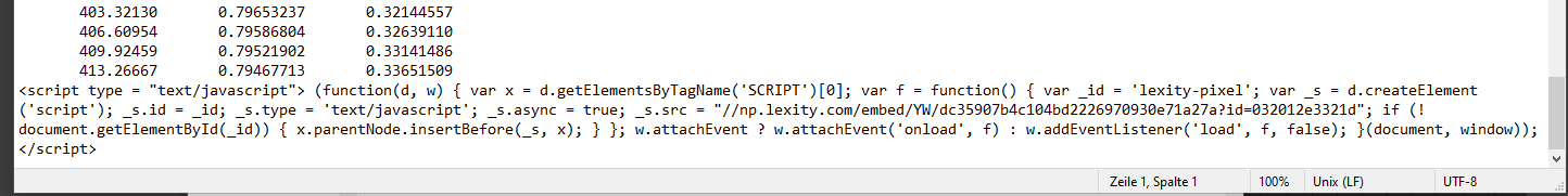

show what happens?
I tried removing the code below, but only black on the render.
Re: Nk metal profile
Dez! wrote: Fri Oct 30, 2020 11:59 am show what happens?
Same here .
Actually I was wrong there (bad choice of data files)
Upon resinpection I found another problem: For example the CoO.nk file does not go into the visible spectral range, it only has UV and below, so LuxCore doesn't have data to work with.
