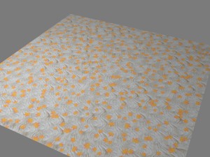

Starting from this background (with randomized tiling):
and using this "bullet":
You obtain:
Note: as the leafs have only a single shape (i.e. orientation, they are pointing upward).

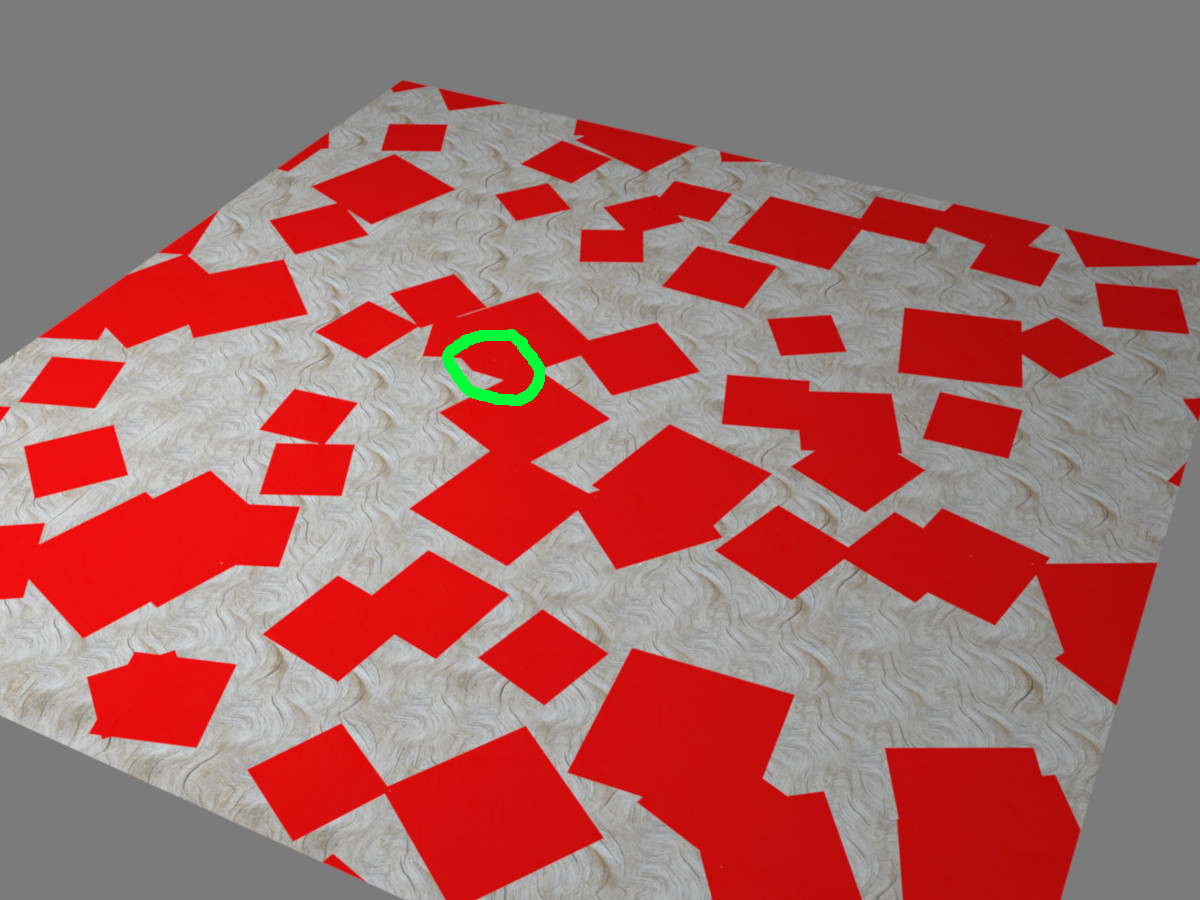

B.Y.O.B. wrote: Fri Oct 02, 2020 3:28 pm Would it be possible to support random rotations for the "bullets"?
In theory no because the diagonal of a square is larger than the edge (i.e. if you rotate the bullet image, it will not feet the original image: you have to cut corners to fit the original size). See the clipped red square in this test:
In practice, this problem is very easy to solve by adding an empty border to the bullet image and, most of the time, it is not even necessary or a noticeable problem.

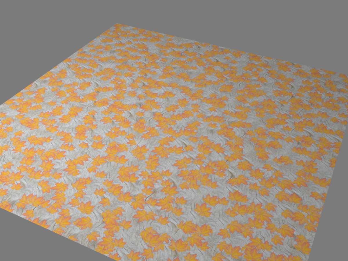

So I added the support for random bullet rotation and scale with the following properties:
# Random scale range, in this case, scale between 100% and 175% (it can be > 1.0).
scene.textures.bombtex.bullet.randomscale.range = 0.75
# If to enable 360 degree random rotation
scene.textures.bombtex.bullet.randomrotation.enable = 1
The result of using a single leaf bullet image:
