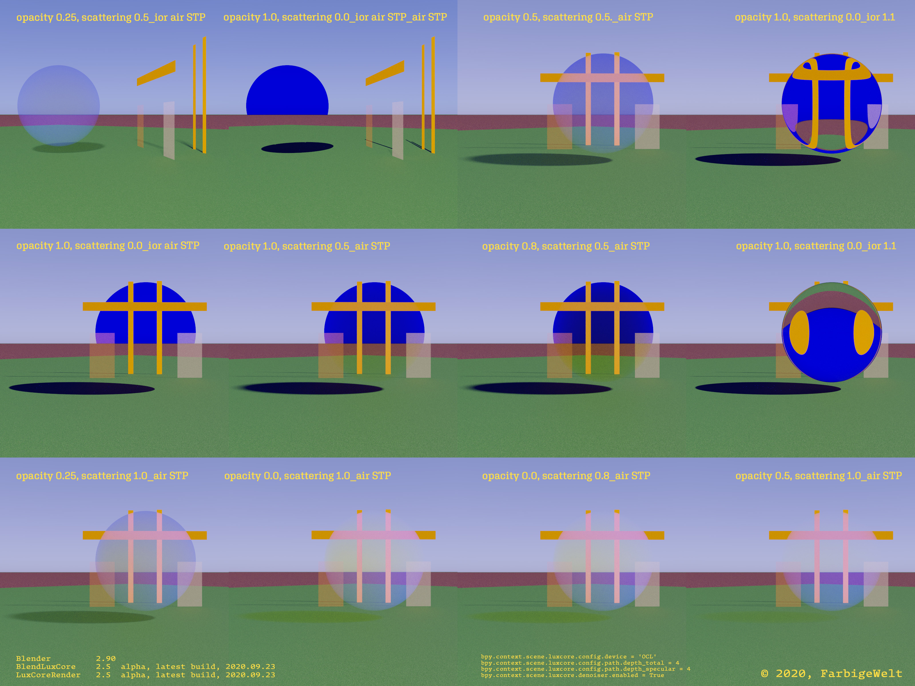

Post by FarbigeWelt »
Glass, Volume - heterogeneous -, strange deep blue color of glass
At the moment Glass opacity is larger than 0.0, means visible, deep blue appears above horizon line.
In my opinion this asks for explanation :?: :?: :?: because I cannot see any physical explanation for this strong saturation of pale blue sky. :!:

Posts: 1083
Re: Where does deep blue of glass sphere come from?
Dade wrote: Fri Sep 25, 2020 10:23 am In general, mixing opacity with transparent materials is a bad idea, they are 2 contradicting properties: opacity literally makes the surface exists/not-exists (i.e. ray tracing can continue, ignoring the surface, it is like a glass with IOR 1.0). So it is like mixing two glasses with different IOR (something that doesn't makes very much sense).
a|Glass material with opacity of 0.0 equals Null material as ever other material with opacity 0.0 does.
Opacity does not have any influence on Volumes but making them less (opacity >0.0) ore more (opacity <1.0) visible. It is only the material surface that renders invisible with opacity 0.0.
b|The opacity series I made to illustrate that there is something very odd with Glass material together with Sky's blue. Even stranger with Matte material reflecting (left box) or emitting (right box) Glass material looks rather correct (in contrast to the sky).
c|Believe it or not opacity of 0.99 for Glass materials can make much sense for some wanted or even from real world 'experiments' expected effects homo- or heterogeneous Volume. Although theoretically this should actually not be required. But I have the feeling Glass material does not behave as it should in certain circumstances even if the formulae implementations are are correct.
Dade wrote: Fri Sep 25, 2020 10:23 am About the specific scene, it is hard to be more specific without having the scene and all volume parameters, etc.
Sure. You can check the scene. Maybe I have done something unusual.
