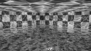

I have problem with Glass material. In a scene where camera is inside glass object volume I can't get reflections on the surface.
When the camera is outside glass object, reflections work as they should.
I've attached rendered image and simple Blender file with this problem.
internal_reflections.blend
(860.17 KiB) Downloaded 2652 times

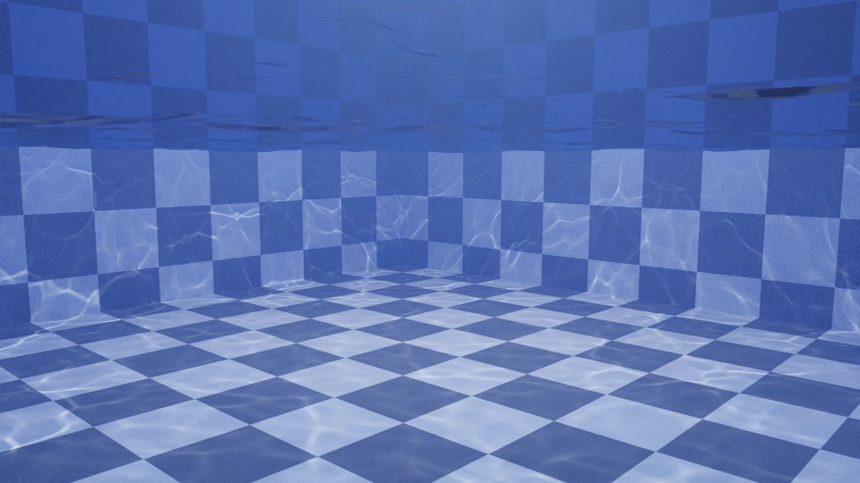

I've tried again, this time instead of bidir I used Path + Light Tracing + PhotonGI, but the effect is nearly exactly the same.

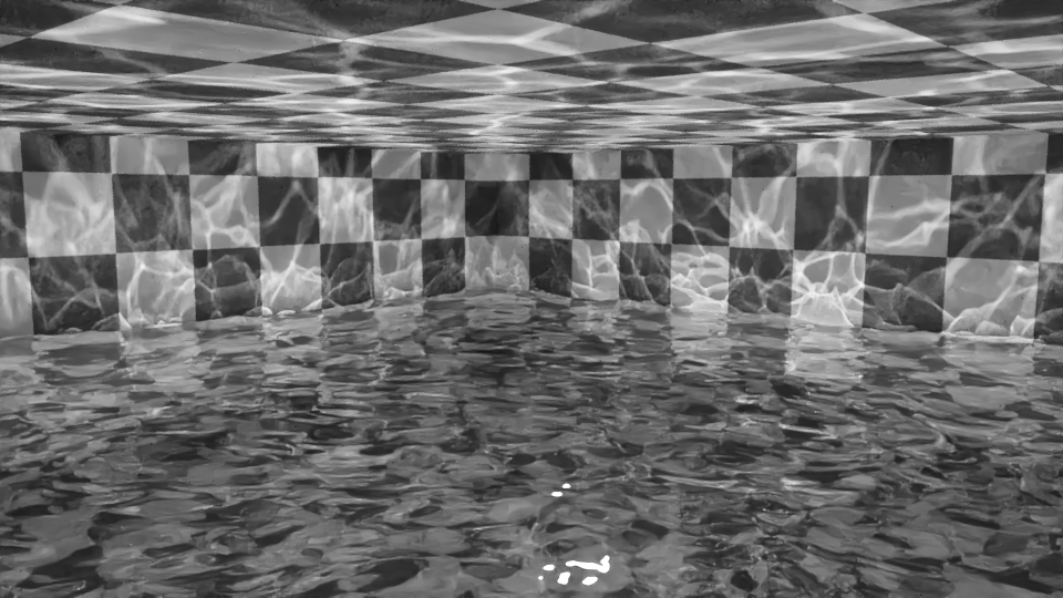

If I invert the setup - place camera above the water, light underwater and change camera volume to air, then water reflections look amazing.
When camera is underwater, the reflections are extremely dark. Maybe it's a problem with glass material being viewed from other side?
74hc595
Posts: 18
Joined: Tue Sep 22, 2020 11:39 am
Re: No internal reflections inside Glass material
Post by 74hc595 »
Also when camera is above water, everything below water is distorted, as it should be, but with camera underwater, things above water are darker, but not distorted.

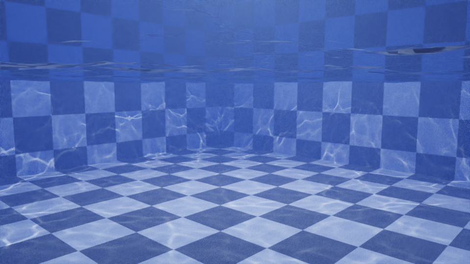

Yes, in the underwater example camera volume is set to water, and in the example with camera above the water level it is set to air. The normals of the water mesh point upwards, interior is set to water, and exterior is set to air. What is surprising, is that while light gets distorted when in passes into the water and creates caustics, but walls above water level in the first image appear undistorted. When camera is above water everything looks ok. I've attached Blender files for both cases.

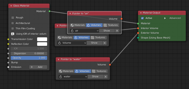

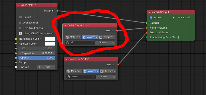

This was tricky to spot:
You have 3 volumes defined in your scene: "air" (1.0 IOR), "water" (1.33 IOR) and "Volume" (1.55 IOR). And you have two perfectly overlapped volume nodes in water surface material definition:
with the wrong one (1.5 IOR) connected to the material.
If you fix the volumes, the scene should render as expected.
