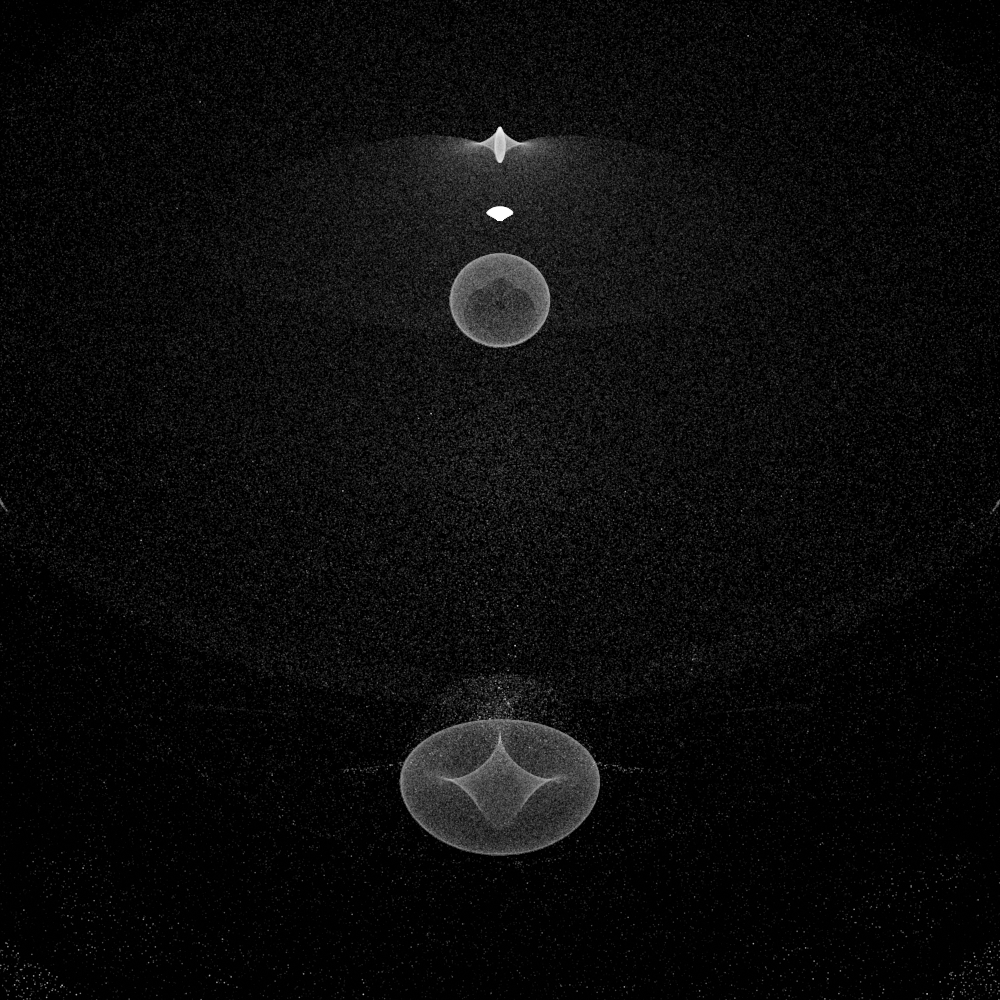

I am currently working on lens systems. One thing I wanted to do is assign slightly different glass materials to different faces - same volume/IOR but different reflection color - to test between which faces certain flares are formed. If I have only one material, I don't know if it came from the front or back surface.
So I created a second material on a lens, made the same settings and assinged it to faces on one side. However, this changes the entire image formation.
In the attached blend file, the faces should be pre-selected. Just toggle between the SF14 material (the original one with correct image formation) and SF14_2.
I had the same problem before when I tried to make one-piece doublet lenses with a volume-volume transition material on the inside faces.
Is there a specific aspect to the glass/volumes implementation from which this is expected, or a bug?

Unfortunately no. I'm not sure if it is a connected issue, but I have noticed it as well.
Also, I don't get the image you posted in your blend file :?:
The correct image rendered through the camera should look like this:

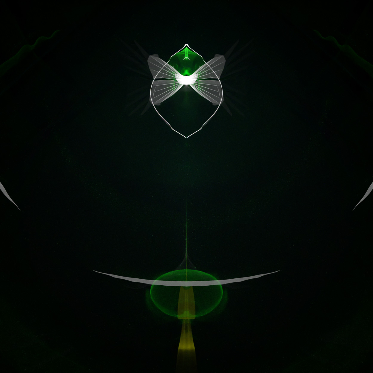

CodeHD wrote: Wed Sep 23, 2020 5:53 pm The correct image rendered through the camera should look like this:
Impressive! Your lens system draws a nice White Butterfly. How amazing!
CodeHD_Lens System_subdivided and reflections colores_denoised
Scene
Scene has some changes. All Glasses has have different colors of reflection now.
Maybe overlapping of meshes should be avoided if one is looking for reflections.
CodeHD, you should improve the code of your add-on. :arrow: See how lens meshes are made fit for Modifier Subdivision.
Probably different effects you thought to be connected with 32 bit floating point precision are because of low polygon objects. I guess the circles of a cylinder should have at least 256 points or 32 points subdivided at least 3 times for the final renders of an Object Shaded Smooth (Cylinders and other objects with faces that should appear flat require Object Data Properties Normals Auto Smooth enabled like you did it for the lenses).
