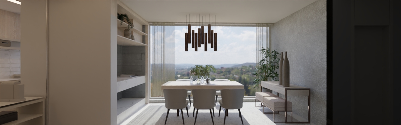

Guys, I have a room with a big window, and the shadows don´t look like realistic. Near the chair legs, the shadows should be more sharp, but shadows are too much soft. The light comes from a HDR. There is some setup specific for this?

It works with direct light (from sun light or HDR), but I´d like a diffuse light (ambient), without sun light entering directly in the room.

Look the example in the attached image. It´s the effect I want to achieve.
Re: Big window shadow
Leandro Oliveira wrote: Thu Sep 10, 2020 2:57 pm Look the example in the attached image. It´s the effect I want to achieve.
So just use an HDRi with the same light/shadow profil OR a sun with appropriate size for full control.
