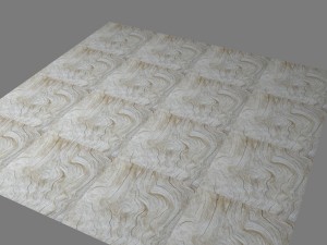

I have the first working version of the support for Brent Burley's "Histogram-preserving Blending for Randomized Texture Tiling" (aka Procedural stochastic texturing).
Given this image map:

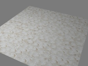

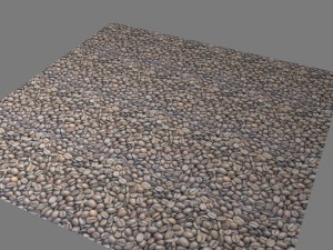

A normal tiled rendering will look like:

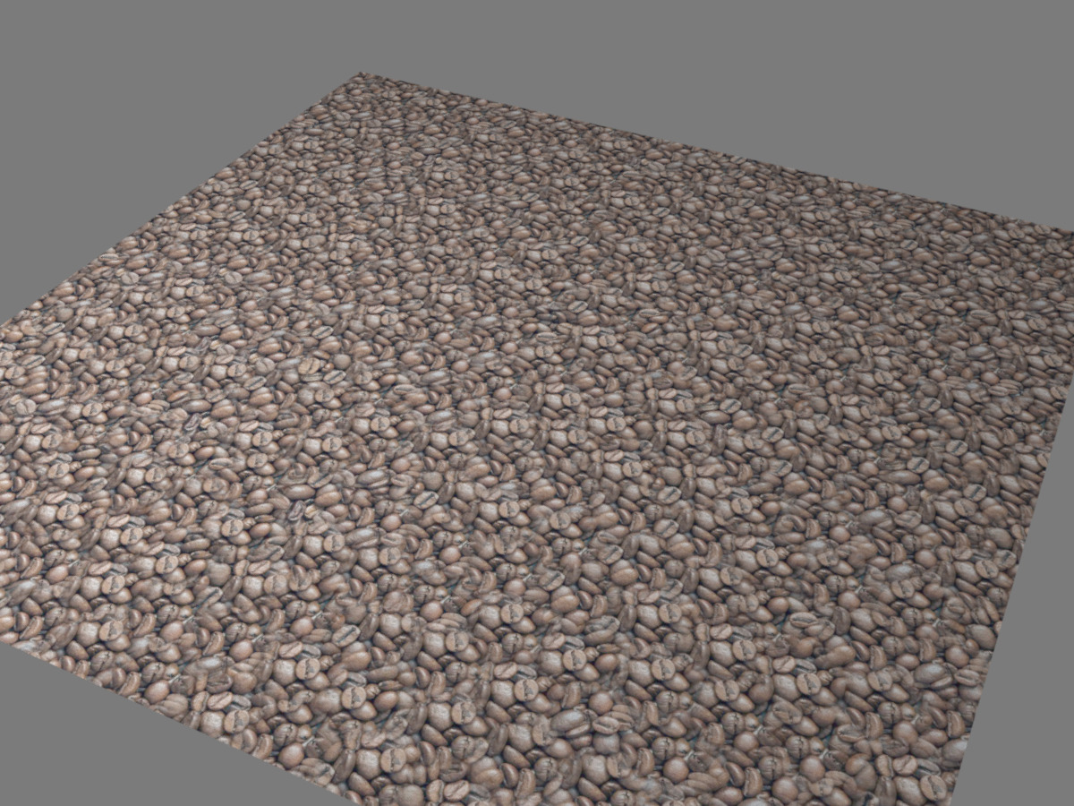

While with randomized tiling:
Another example:
The support can be enabled by just setting the ".randomizedtiling.enable" property to 1:
scene.textures.imgtex.randomizedtiling.enable = 1
Quite amazing stuff !

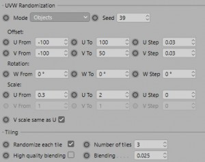

Are there any plans for custom controls like U&V offset, rotation & scale, amount and type of blending?
Here's corona's version for example
