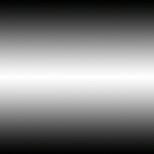

I know there is a node called "Blend" to do it and it works quite well but there is one thing I can't do. I want to get the typical "reflected" gradient but I couldn't find a way to control this node to create that effect. I also tried with the "Band" node, but sincerely I didn't understand it. I attach an image of what I would like the final outcome look like, to give you a better idea.

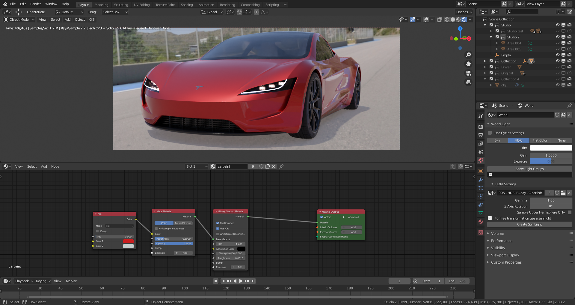

Aside from this, I also wanted to create a pearlescent kind of car paint. To do so, generally you want that the surfaces that are facing perpendicularly to your point of view have a certain color whereas the adyacent ones have other (in short, I'm looking to create a color gradient based in the fresnel effect). Is there any way to control the base color like that to make this effect in luxcore?

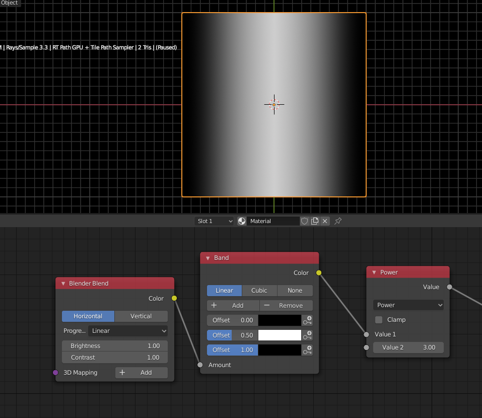

PDRA wrote: Tue Aug 18, 2020 6:10 am I know there is a node called "Blend" to do it and it works quite well but there is one thing I can't do. I want to get the typical "reflected" gradient but I couldn't find a way to control this node to create that effect. I also tried with the "Band" node, but sincerely I didn't understand it. I attach an image of what I would like the final outcome look like, to give you a better idea.
You can use the Blend texture to get the basic gradient, then use a Band/Colorramp node to remap it so it is brightest at value 0.5 and starts to get darker again toward 1. The gradient in your example picture seems to be non-linear, maybe exponential. To get that, you can use a math node in "Power" mode.

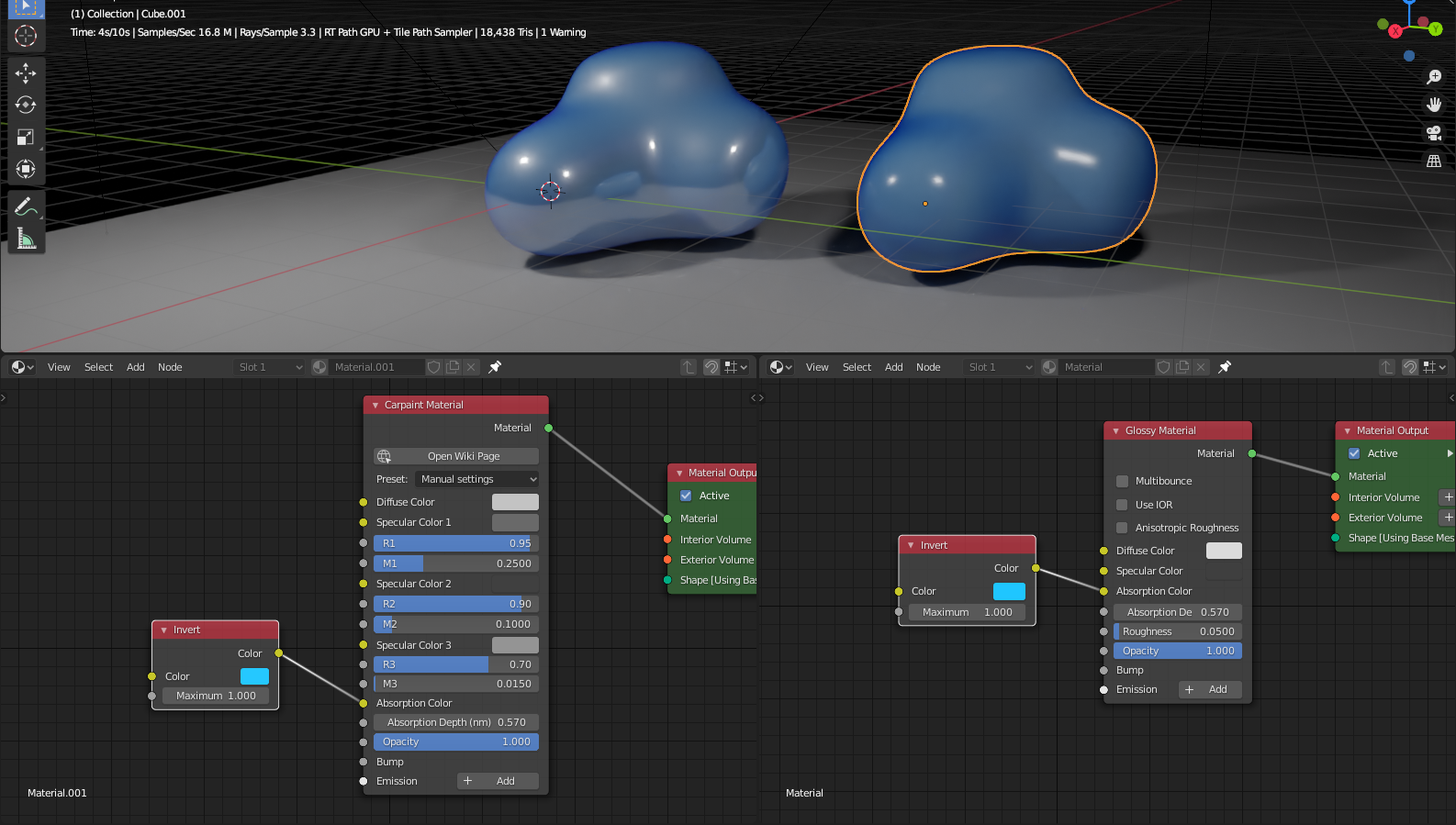

PDRA wrote: Tue Aug 18, 2020 6:10 am Aside from this, I also wanted to create a pearlescent kind of car paint. To do so, generally you want that the surfaces that are facing perpendicularly to your point of view have a certain color whereas the adyacent ones have other (in short, I'm looking to create a color gradient based in the fresnel effect). Is there any way to control the base color like that to make this effect in luxcore?
You could check if the absorption color is enough for your purposes.
I don't think we have a possibility to use an arbitrary color gradient depending on viewing angle.
carpaint.blend
(738.5 KiB) Downloaded 611 times

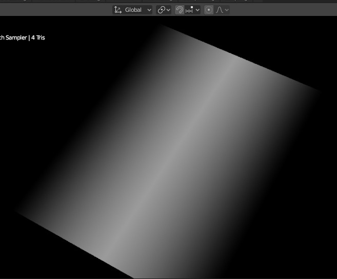

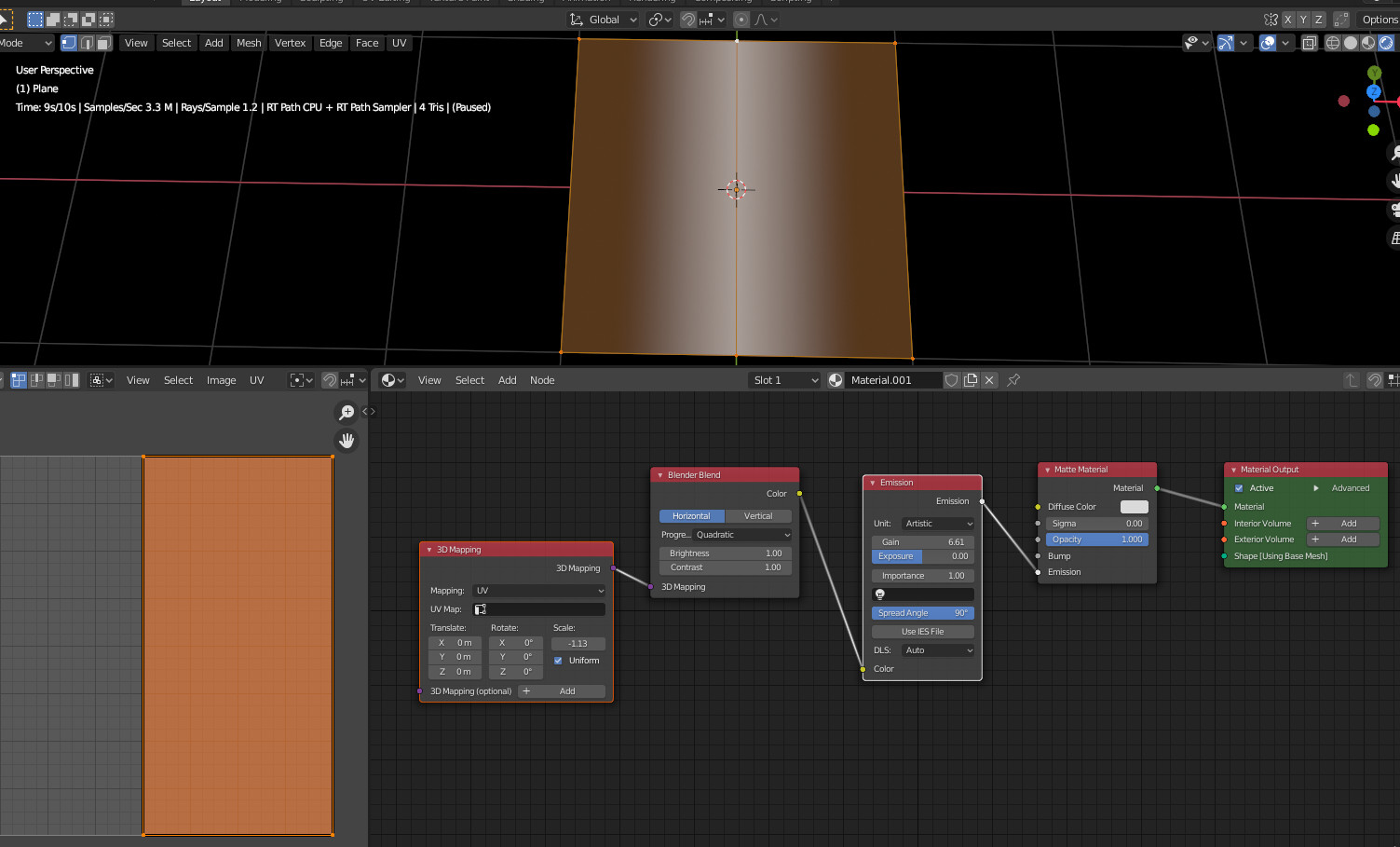

For your gradient light Maybe this can Help :
Blendfile:
gradient_light.blend
(696.79 KiB) Downloaded 633 times
Edit You're fast BYOB :D : will study you're setup. Mine is using Uv mapping :

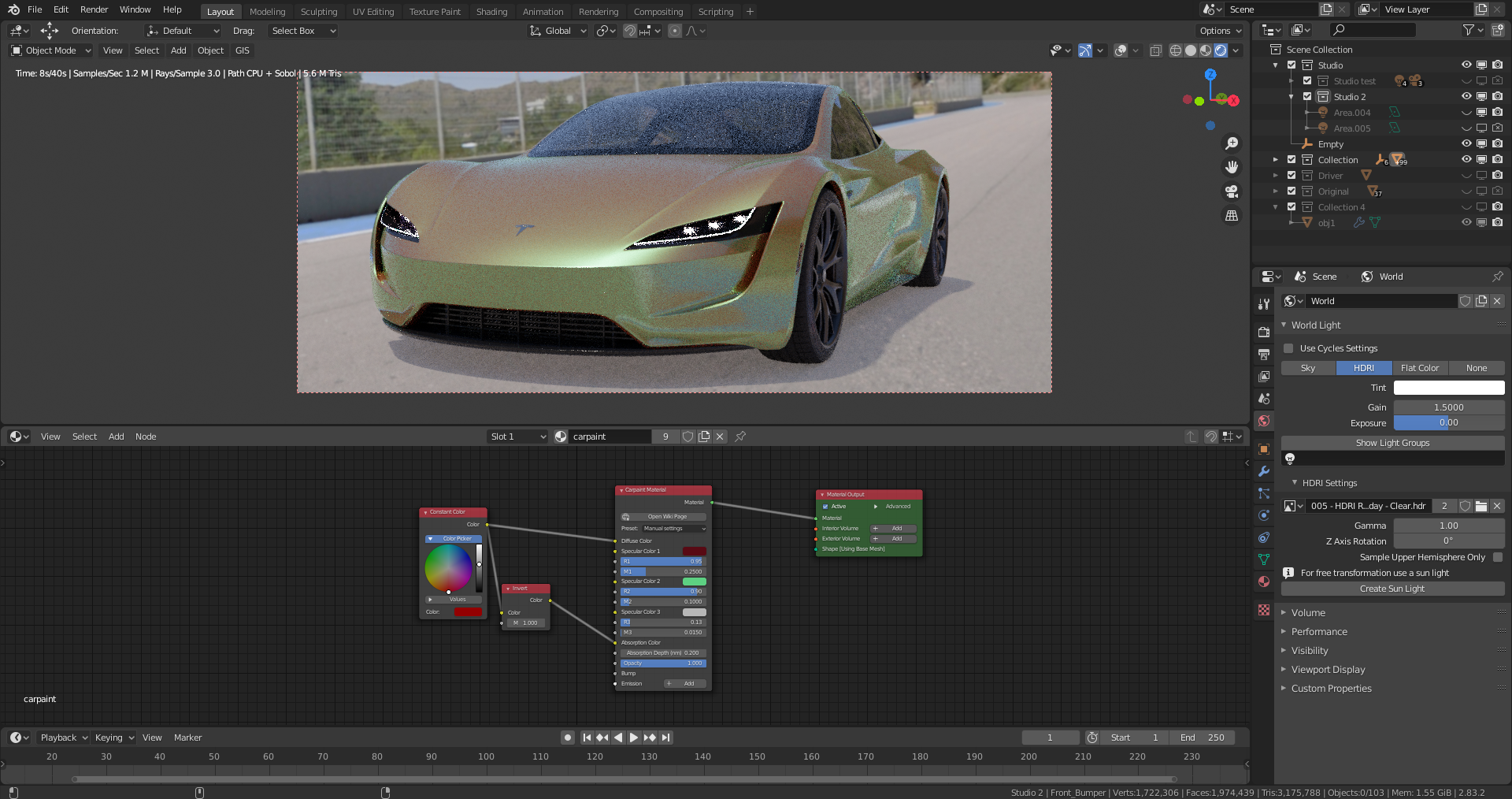

Apparently playing with the absorption (color and values) and changing the different colors for the different layers of the car paint can give you the chance to control it and be able to create this effect! However, it would be great to make it possible for other materials such us the Disney. A node like the Fresnel/fallof that 3ds max has would be great for this purpose.

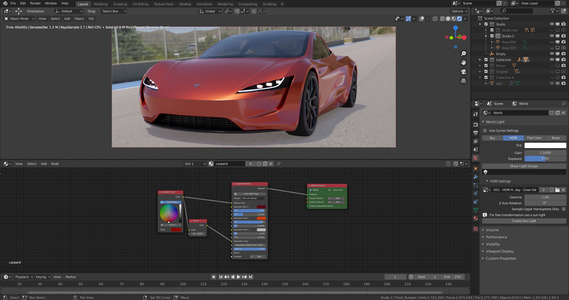

Test 1 - Pearlescent effect (exaggerated)
Test 2 - Aproximation to the effect wanted (mix of red and a little orange)
Test 3 - Current car paint setup
I think I will be using the test 2 approach, even though I like the control over the fresnel effect determined by the IOR value of the test 3 setup has.

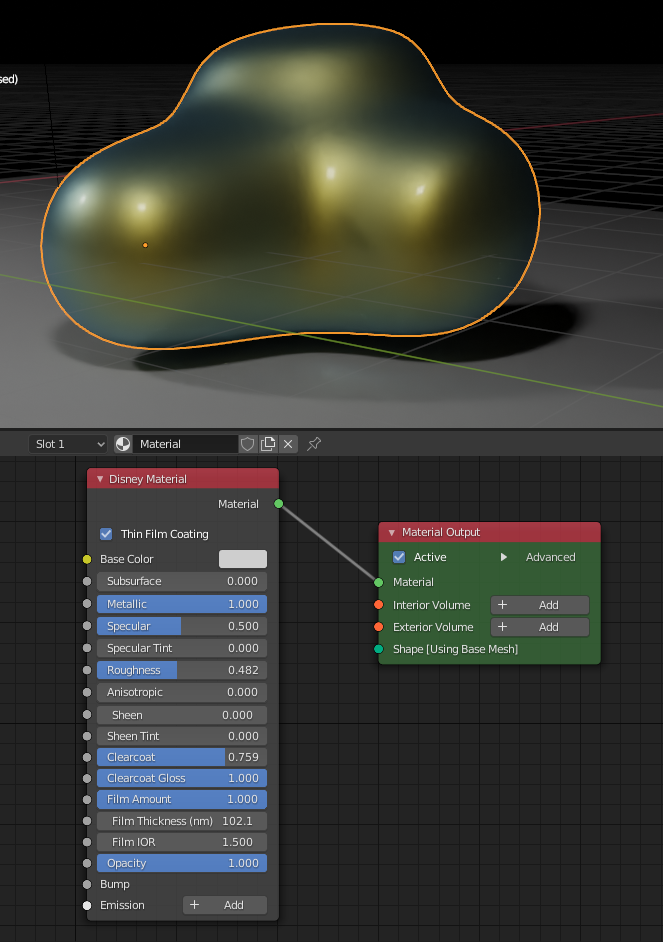

IIRC some car paints in the real world also use thin film interference to achieve this effect. In Lux you can use a disney material for this.
To use it, enable "Thin Film Coating" and adjust the film thickness. You can see which colors to expect at which film thickness in charts like here: https://soapbubble.fandom.com/wiki/Colo ... _Thickness
