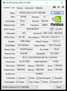

Odilkhan Yakubov
Posts: 214
Re: Installing Windows 10
Post by Odilkhan Yakubov »
Dade wrote: Thu Aug 13, 2020 10:27 pm It is really strange, GPU-Z show you GTX 1060 but it says CUDA is not available :?: I think it is not even possible to have NVIDIA drivers without CUDA :?:
Here GPU-Z screenshot (I installed Nvidia driver one by one v442.19, v451.67 and v451.77 studio and GR too) and used DDU (Display driver uninstaller for clean uninstalling from system):

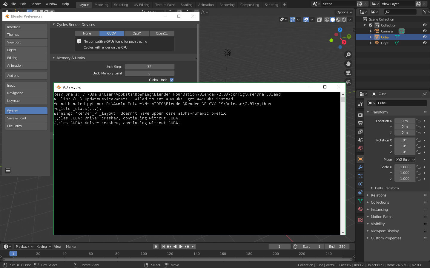

Blender also write error while I opened Blender and checked console:

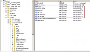

Odilkhan Yakubov
Posts: 214
While I posted above messages I noticed/remembered that I changed regedit some settings as I used E-Cycles too (from bliblubli instruction). I added this "red bordered" settings into regedit and after remove it shows CUDA :mrgreen: 8-)
