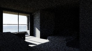

black caches render
black caches render

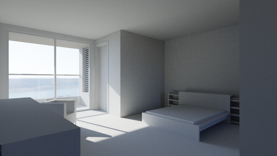

just install lastest stable 2.4 blendluxcore and get issue with caches. without caches my render is brighter as expected.

You should enable PGI and/Or Env cache to see the bug.

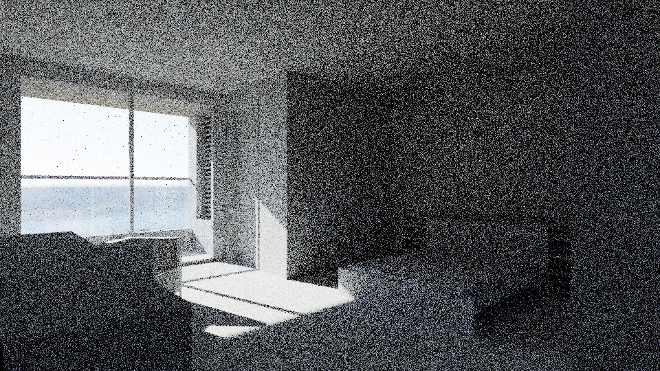

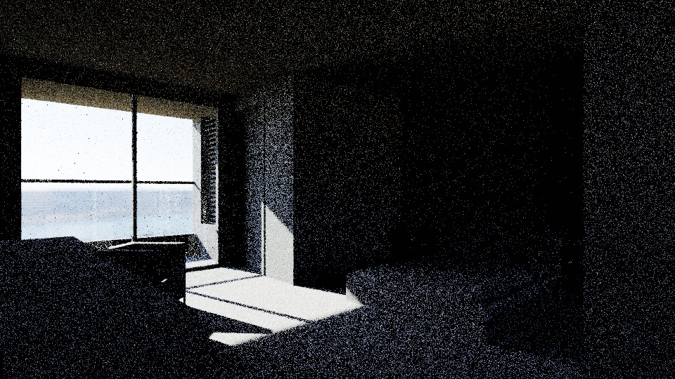

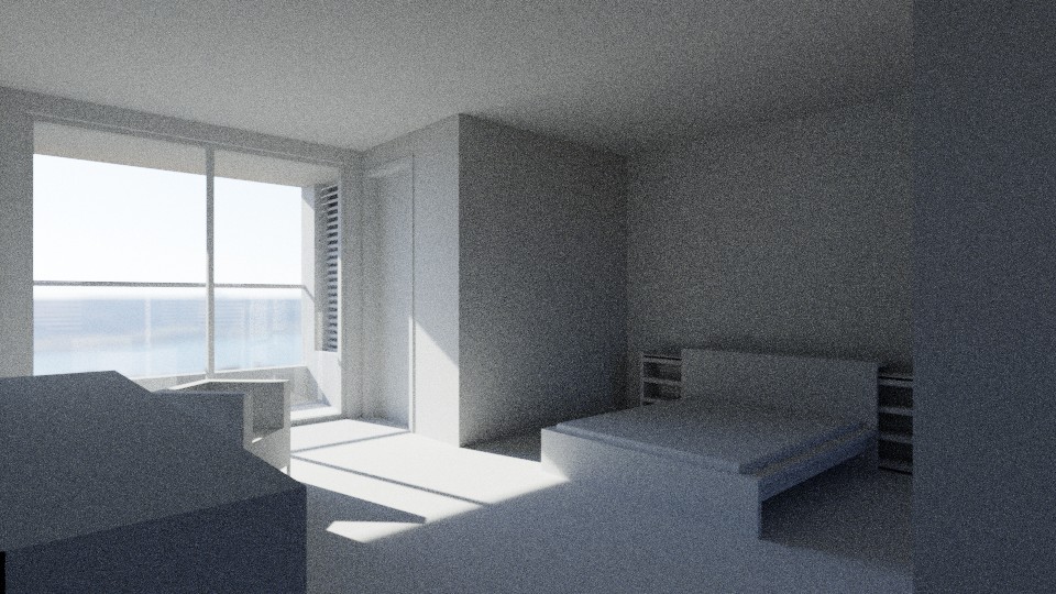

It looks like this on my end:
(300 samples)
Caches enabled
Caches enabled
Caches disabled
Caches disabled

Still the same issue. i have deleted/reinstalled blender. Strangelly my colleague don't have the issue.
