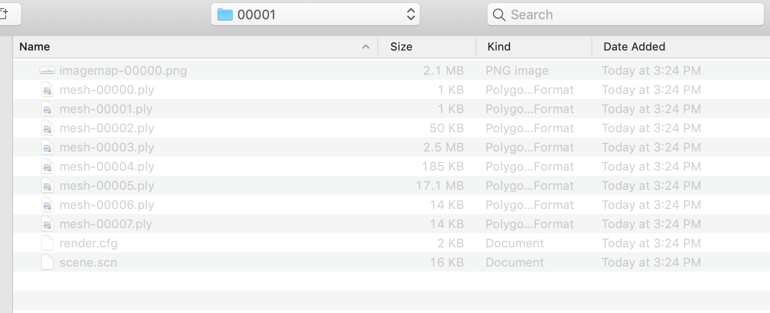

When I launch LuxCore Network Render from inside of blender and then open a NetConsole window and then "add job" I am not able to select the .cfg file. All the files are greyed out. See attached image. Has anyone else encountered this before? I've attached a screenshot of the file browser window.

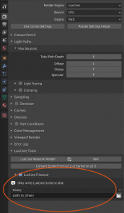

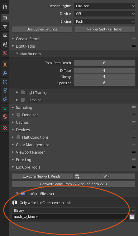

Save as binary, it will generate .bcf file which you will be able to select.

Thank you. Such an easy fix, and this is specified in the Wiki, but I just didn't notice it.

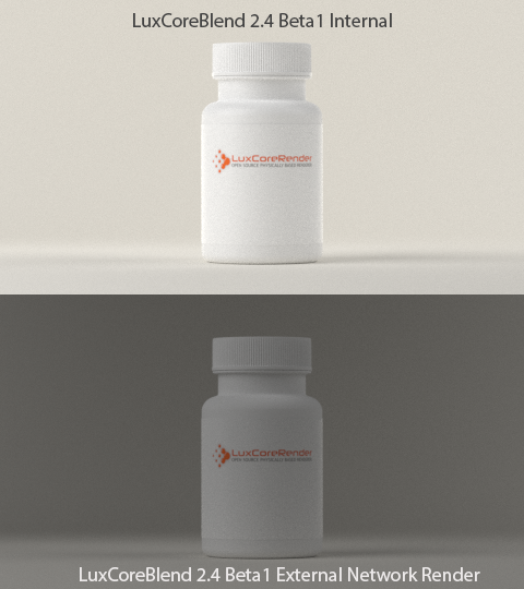

A little bit of a follow up question now that I have the Network Render option working, I can't get the external Network Render to look the same as the image when rendered internally. I have Color Management set to have everything turned off, I think anyway, but the external render still looks significantly darker than the internal render. Any chance you have come across this issue also?

Thanks for the quick reply. I've attached an image comparing the internal and external render, and also the .cfg file, however the external render was run from a binary .bcf file, but I exported the .cfg file immediately afterward and didn't change any settings.

The imagepipeline defined in the .cfg looks normal with tonemapping and gamma 2.2.
I have done a simple test with Blender and a simple cube-over-plane scene: I get the same output inside Blender and outside Blender with an exported scene (with LuxCoreUI, Network rendering, etc.).

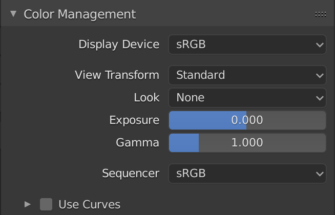

Can you do the same test with a fresh scene ? You may have some setting different from Blender default in your scene. Note: my default Blender "Color Management => View Transform" is set to "Filmc", yours seems set to "Standard".

Dade wrote: Sun Jul 19, 2020 10:16 am Can you do the same test with a fresh scene ? You may have some setting different from Blender default in your scene. Note: my default Blender "Color Management => View Transform" is set to "Filmc", yours seems set to "Standard".
