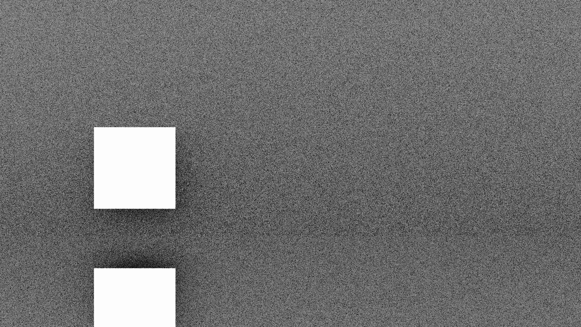

To give a bit of context, what we have here is a meshlight which is invisible to the camera and has a white shadow color. Despite that, it still throws a slight shadow on the wall.
My response on discord was:
@marcatore It looks like the shadow color is not considered for global illumination rays.
When I change the ground plane to black matte, the shadow disappears. I think it comes from the fact that the whole wall is lit up slightly by indirect light from the ground, but this indirect light does not respect the shadow color and is blocked by the area light.

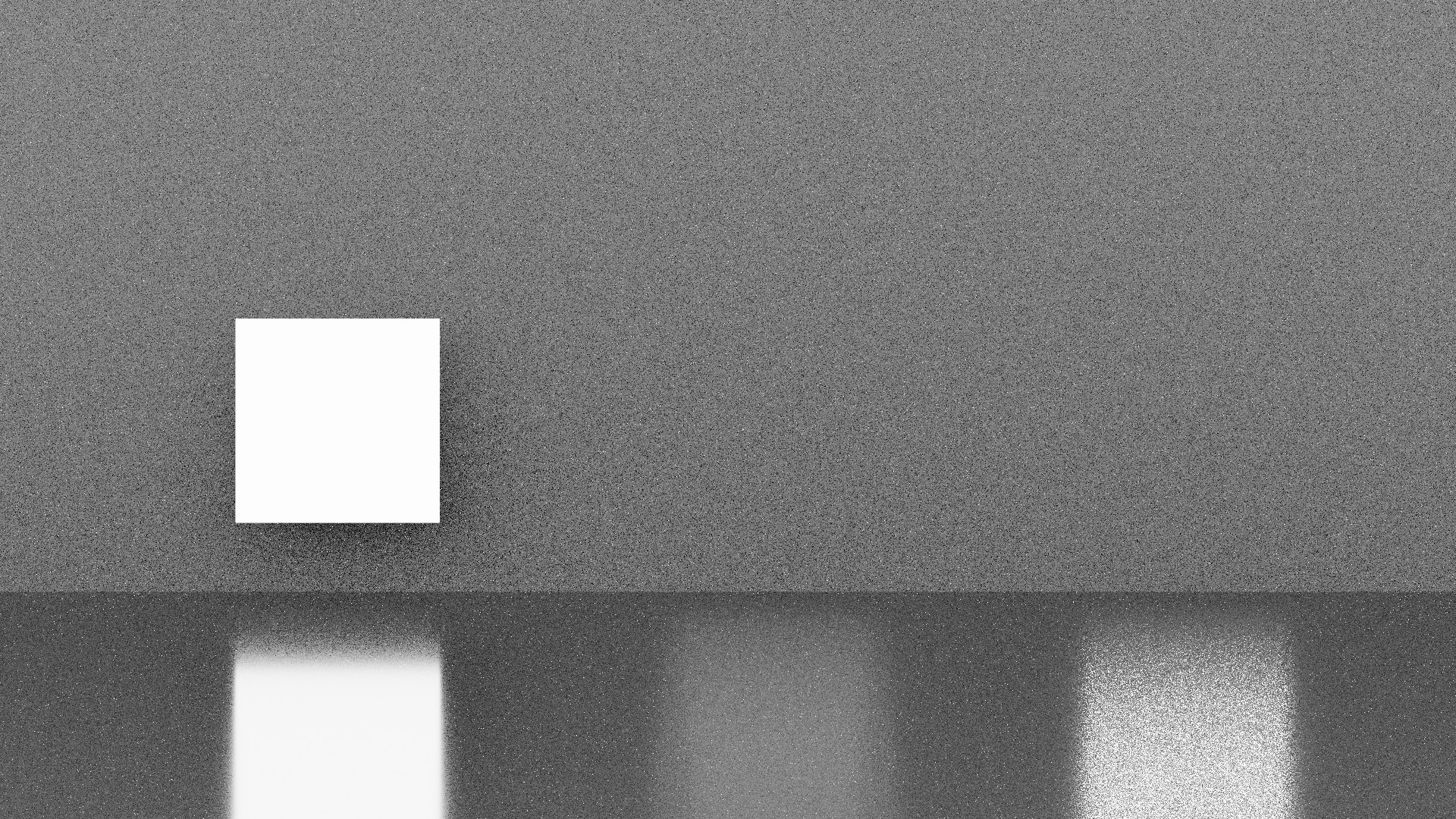

Re: Full invisible area light
It looks like it is now partly invisible in glossy reflections and completely invisible in specular reflections.
From left to right: meshlight completely visible, meshlight invisible to camera and shadow color white, meshlight opacity = 0
At least it doesn't create noise like the meshlight with opacity = 0.
floor is metal
floor is metal
floor is mirror
floor is mirror

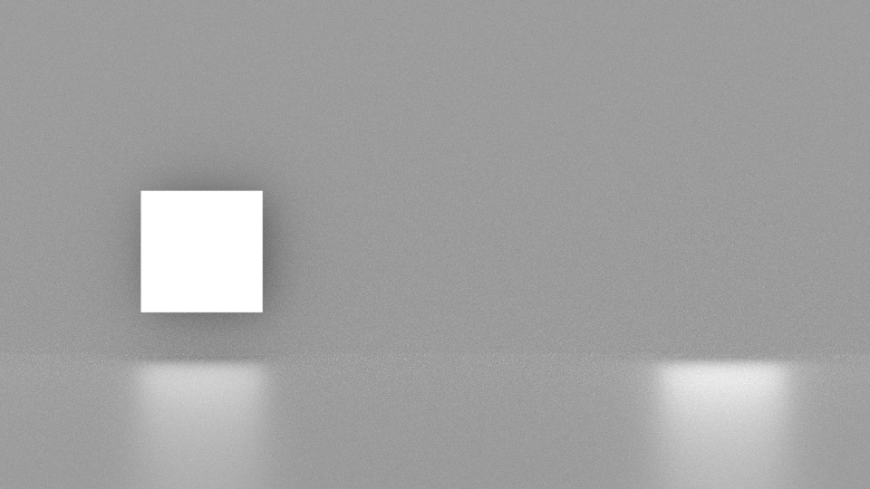

I've test the invisible light with direct light. It seems that it emit less light.
I've attached a PSD with the 2 images that show the lighting difference.
invisibleLight_difference.zip
(2.68 MiB) Downloaded 1213 times
