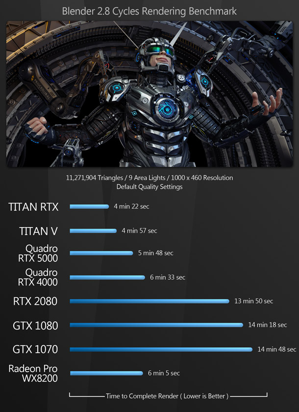

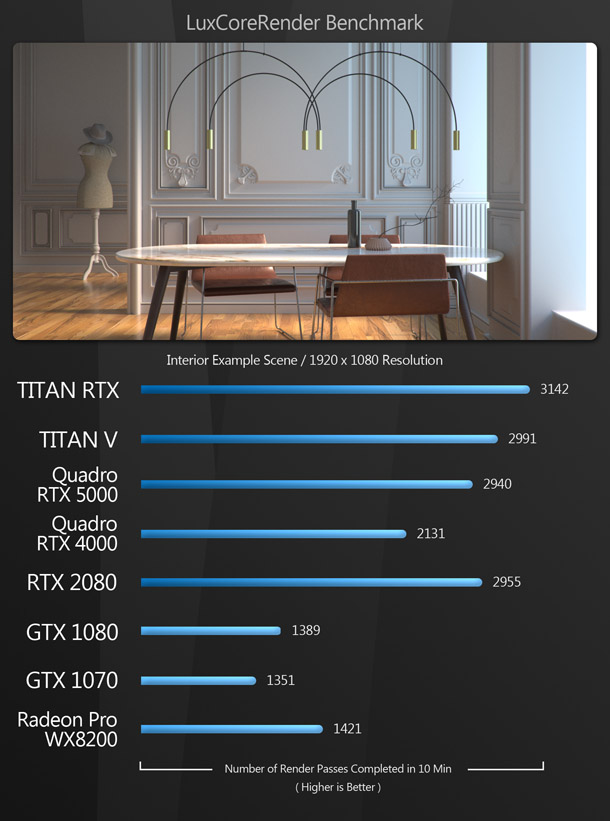

Radeon Pro WX8200 performs twice better with Cycles and twice worse with LuxCore. I wonder why is that?
Why Radeon Pro performs so miserably with LuxCore?

Have Cycles tests been done with OpenCL ? I mean I flip the question: the Cycles results look very inconsistent to me and it would not be a surpirse because Cycles OpenCL has more than one problem and OpenCL is a bit gimped on NVIDIA.
If you look at LuxCore results, the WX8200 is slightly faster than the 1080TI and slower than the Titan: it is the kind of result I would expect.

Well, it doesn't say but I assume the Cycles test is done with CUDA.

Cycles with CUDA Vs Cycles with OpenCL isn't exactly an "apple to apple" comparison. If you want to compare only the hardware, you should use the same software otherwise it doesn't look like a fair comparison to me.Storen wrote: Sun Jun 07, 2020 5:44 pm Well, it doesn't say but I assume the Cycles test is done with CUDA.
Harsh version: Vega is the only good GPU, for computing, AMD has produced in many years. Basically, since HD7970 (amazing GPU), AMD has recycled only old architectures or stretched low-end/mobile designs. Vega had its set of faults (probably hot and expansive to produce) but was good too. I would expect to be competitive with a 2080TI.Storen wrote: Sun Jun 07, 2020 5:44 pm How do you expect Radeon Pro WX 9100 would perform compared to 2080TI?

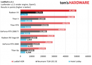

According to Tom's Hardware RX Vega 64 outperforms slightly 2080 but it is seriously behind 2080TI.

Radeon VII is still a Vega GPU (Vega 20), RX Vega 64 should be a "Vega 10 XT" GPU. As far as I remember, "Vega 20" was manufactured on a better fabrication node than "Vega 10 XT" but is pretty much the same architecture. Wiki seems to confirm what I remember: https://en.wikipedia.org/wiki/Radeon_RX ... e_graphicsStoren wrote: Sun Jun 07, 2020 9:33 pm According to Tom's Hardware RX Vega 64 outperforms slightly 2080 but it is seriously behind 2080TI.

It seems that Vega20 is the best GPU for LuxCore at the moment. Too bad ATI discontinued them.
Do you expect when CUDA is implemented in the next version of LuxCore, 2080TI(CUDA) would perform faster than Vega20(OpenCL)?

CUDA is already implemented and available, RTX will be soon too so the advantage in complex scenes should be noticeable.Storen wrote: Tue Jun 09, 2020 12:25 am Do you expect when CUDA is implemented in the next version of LuxCore, 2080TI(CUDA) would perform faster than Vega20(OpenCL)?
