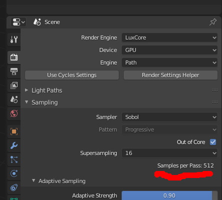

Under the "Sampling" panel there is the information of how many samples per pass you are going to have:
So you can use an halt condition of 512, 1024, etc. with the default settings.
