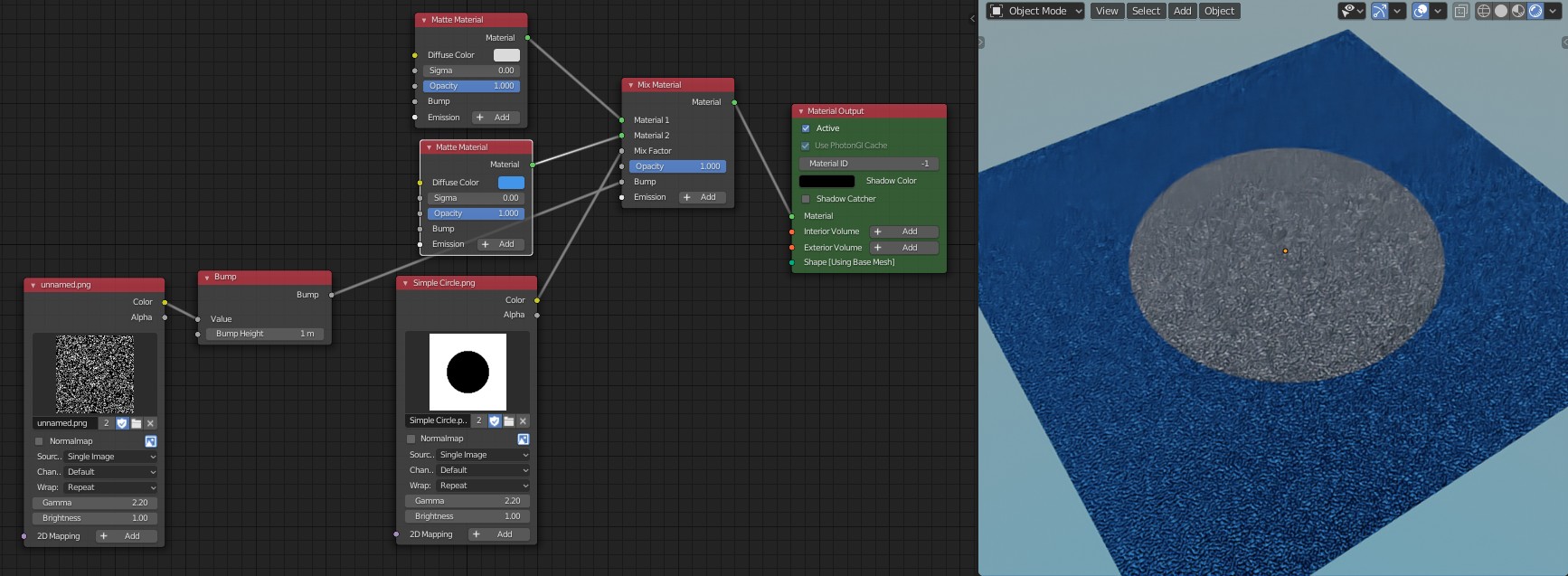

In the first example (Bump01.jpg), the bump texture is applied to the Mix Material. The bump effect is very pronounced and easy to see.

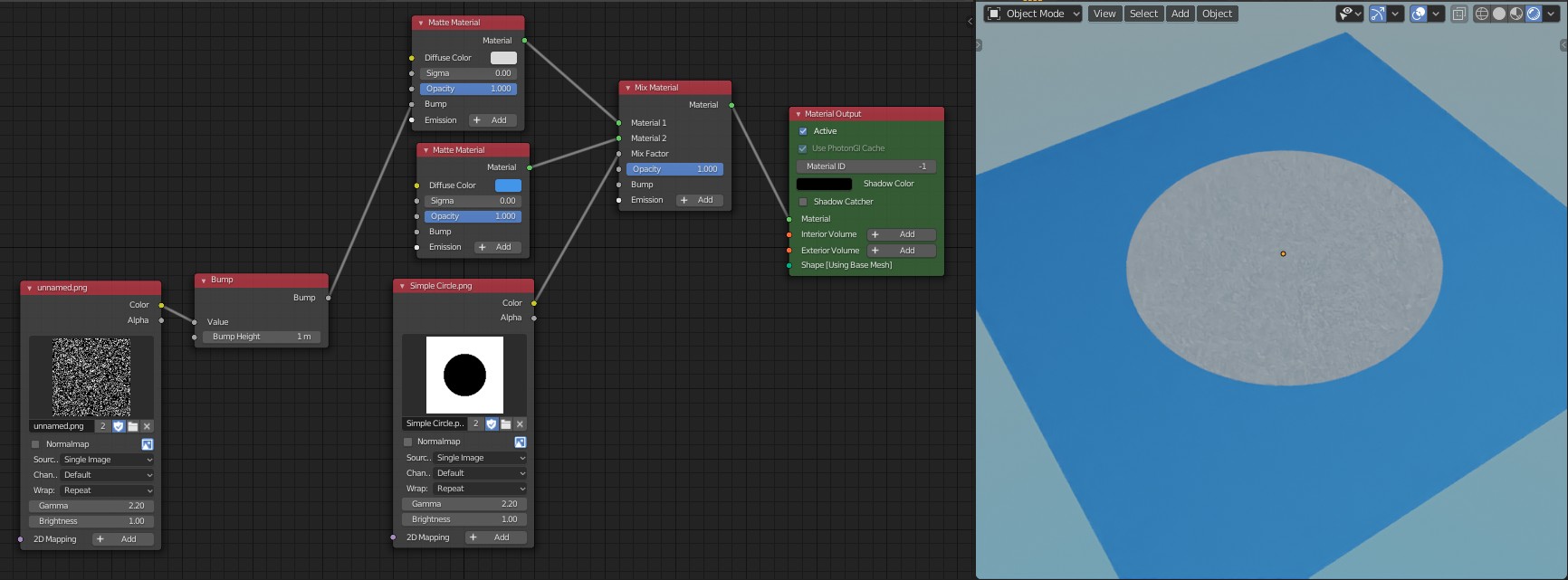

In the second example (Bump02.jpg), the bump texture is applied to the white sub material (the white circle). The same texture now appears very subtle, almost invisible.
Has anyone else noticed the same problem?
I am not sure if that is a bug in the software or it is intentional and I am missing some material nodes that could bust the effect.
I am running LuxCore 2.3
Re: Problem with Bump (possible bug)
Storen wrote: Fri May 29, 2020 4:57 pm I am running LuxCore 2.3
There was some known limitation in v2.3 about Mix+Bump, can you re-try with v2.4 ?
