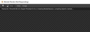

This is what OP is talking about, and I have the exact same issue (attached file):
How to proceed? It is NOT a driver issue.

Maybe post your console output from Blender, it will show where the export/compilation is getting stuck, then people might be able to help. Here for each OS:
