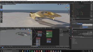

I'm now dealing with this issue.
I have found that luxcore doesn't create proper caustics effects when I add the landscape geometry in my scene. I've notice that the calculations "disipates" when the geometry gets bigger. I've checked it creating a plane and while I scale it, this issue happens.
I've tried applying a transformation reset to make the scale of it to 1 but it didn't work.
I attach some images of what happens when I turn on and off the geometry.
Is there anyway to tell the engine to not consider this geomtry for these caustics calculations?

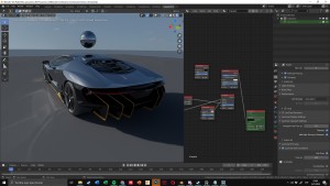

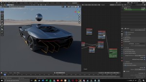

I am thinking that maybe a way to sort this out is to do the render without the background and later add it with other render... but I don't know.. it would be great to take it in one shot as I'm planning to do many takes from different angles
B.Y.O.B. wrote: Wed May 13, 2020 1:21 am Can you post two converged renders with more samples?
I didn't quite understood what you mean with converged, but I added more time to get more samples and I changed the materials to make the effect more evident. Let me know if this is what you meant!

PDRA wrote: Tue May 12, 2020 11:27 pm I have found that luxcore doesn't create proper caustics effects when I add the landscape geometry in my scene. I've notice that the calculations "disipates" when the geometry gets bigger. I've checked it creating a plane and while I scale it, this issue happens.
This is somewhat expected because, as written by Fox, environment light sources emit light from the bounding sphere of the scene (including camera position). The probability to find the caustic paths from a very large sphere become so small to be impractical and often impossible due to (the lack of) numerical precision.
PDRA wrote: Tue May 12, 2020 11:27 pm Is there anyway to tell the engine to not consider this geomtry for these caustics calculations?
There are several way to work around this problem, for instance:
1) render the scene with CPU-only, light tracing 100% and a ground plane only large enough to contain the caustics. This type of setup will produce a caustics-only rendering (it is like having a caustic AOV).
2) render the original scene with GPU+CPU, light tracing 0% (but still enabled). This type of rendering will produce a normal rendering without caustics disabled.
3) just add the 2 images and you should get the correct result without having the problem to render the caustics over a very large plane (because they were rendered over a small one).
