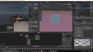

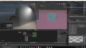

I wanted to know if someone could help me a bit with an effect I want to achieve.
It is called atmospheric perspective. It is an effect that lets you perceive a bit better the distance of the surroundings.
It is mainly perceived in big scenes like landscapes.
I'm trying to achieve this effect but I couldn't find any even close solution yet.
I have been trying with a big cube with some volume material but it doesn't make the effect.
Optimally it would be great if it could detect the lighting produced from an HDRI.
I will really appreciate your help. I have attached the raw WIP + the image with a quick pos pro in photoshop to show the kind of effect I would like to achieve
Also, it would be great to know which is the optimal way to create a gradient (linear radial and so one) in this engine. I'm finding this very common thing very difficult. The best way I had achieved it is by creating an image in photoshop...
A side note, I have noticed that the volume shader is a bit bugged you have to create a new output because with the original one that is created the cube shows completely black.

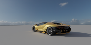

It works really nice. It is kind of a pity that it has jagged edges though.. I don't know if there is a way to solve this inside its settings.
Aside from this if anyone know how to create gradient textures in an easy way, it will defietely will get me entertained at least for some days.
I attach the advance I could make with your help zeealpal!

I add a little question more.
I 've noticed that the mist effect doesn't apply through transparent materials. Is there any option to make it vissible in this situations?
I attach my new wip image where you can see the difference Also is it it possible to extract the mist map as an image to use in pos pro?
