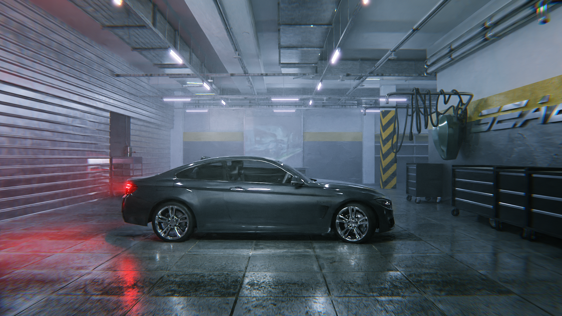

My scene
this scene is optimized for animation i shouldn't exceed 5 min rendertime if i want this to become a reality. but as soon as i add my volumetric box BOOM convergence become seriously slow. 1H45mn for this

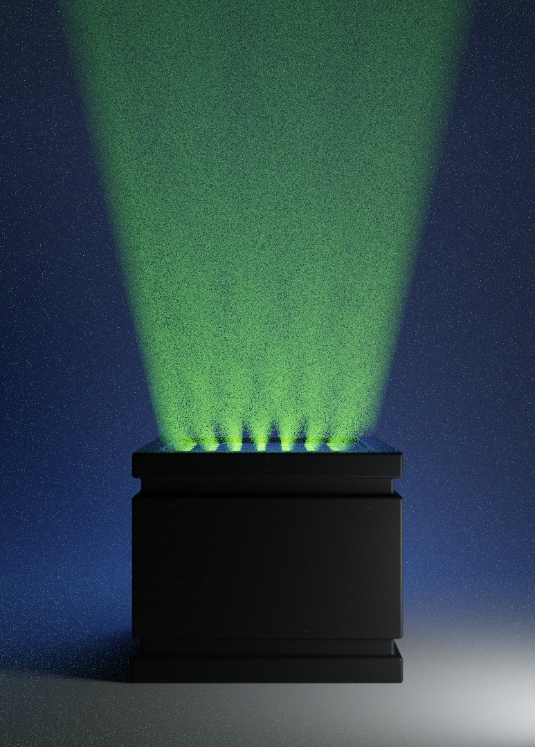

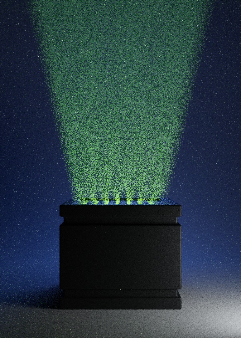

so i create i small test scene for both cycles and luxcore.
Luxcore

Cycles
Maybe an idea
Cycles have separate setting for volume max bounce (it is set to 0 by default) and it is really fast at 0. become a bit slower at 12. but still faster than luxcore.
