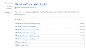

Hello,
When I install BlendLuxCore from github -BlendLuxCore latest build-
both the -BlendLuxCore-latest-win64-opencl.zip- and the -BlendLuxCore-latest-win64.zip- tell me:
--> No OpenCL support in this BlendLuxCore version
Could they be the same files?
Please have a look at the attachment, for every OS version the OpenCL and the standard version the file sizes are he same..

Thanks, when will this be available on https://github.com/LuxCoreRender/BlendL ... tag/latest ?
It still says - released this 19 hours ago-
Or is there a different download url?
Re: OpenCL does not work?
greyscale wrote: Thu Apr 23, 2020 12:48 pm Thanks, when will this be available on https://github.com/LuxCoreRender/BlendL ... tag/latest ?
You can check the status of last builds here: https://dev.azure.com/LuxCoreRender/Lux ... der/_build
The last build with the fix has failed, going to check why.
Dade wrote: Thu Apr 23, 2020 1:33 pm The last build with the fix has failed, going to check why.
For no apparent reason aside a connection timeout with GitHub, I submitted another build.
