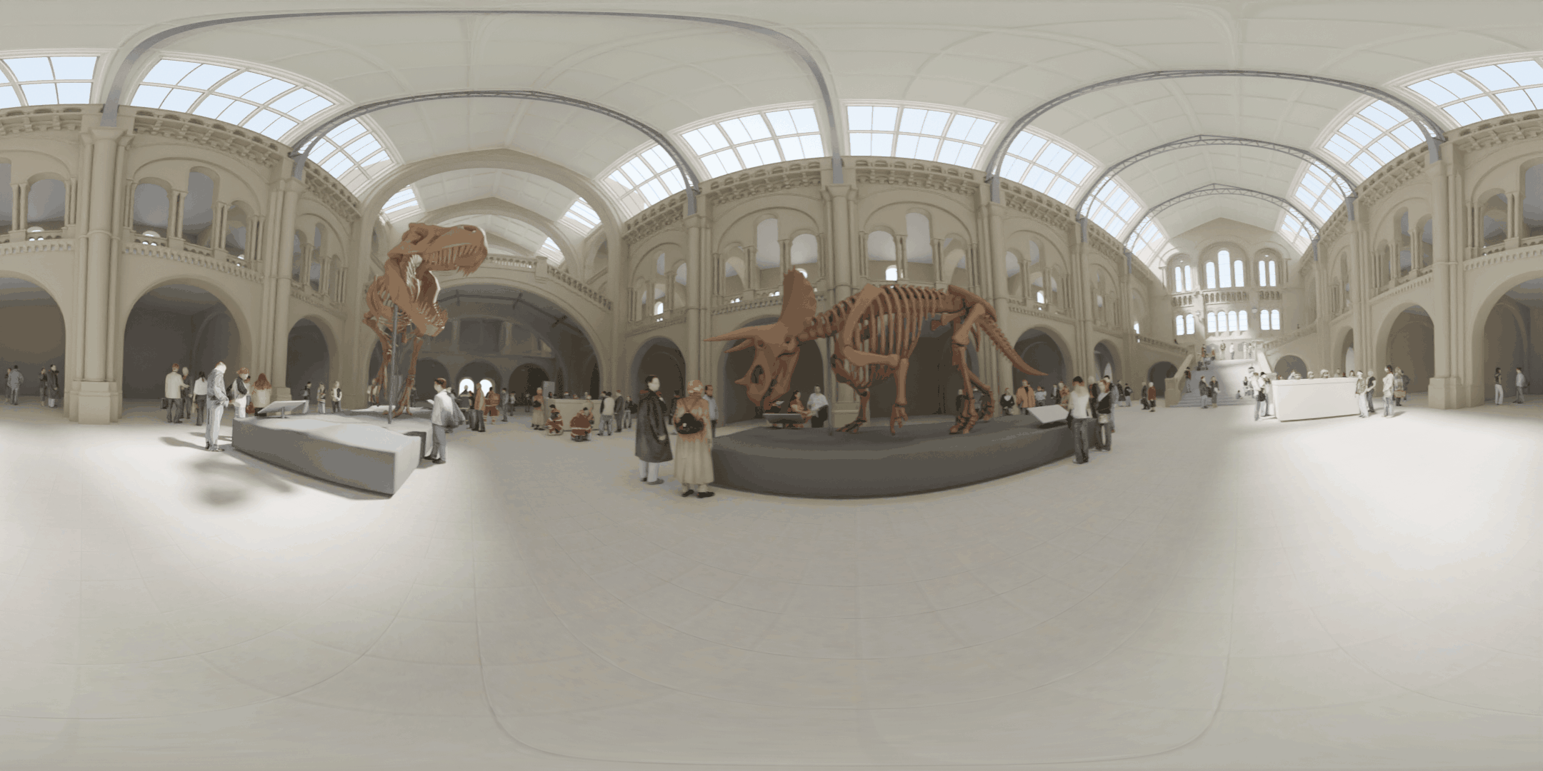

I would like to make a small FullHd video with this file, having a reasonable rendering time.
This is a first rehearsal:
0001-0049.mp4
(1.41 MiB) Downloaded 596 times
It came discreetly but the denoise causes artifacts and flickering.
Do you have any suggestions on how to avoid them?

In general, if the denoiser causes artifacts and flickering, you need to render more samples.

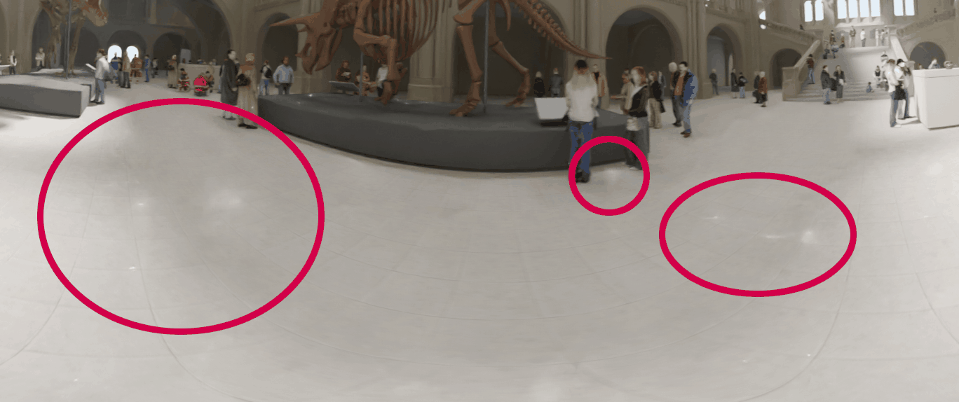

I tried: it reduces the problem of the denoise on the distant parts but white spots appear that go around.
I try to double the calculation time.
Re: Flickering video
They may be denoised fireflies, how does the not-denoised frame look ? Are you using variance clamping ?

Clamping was disabled.
Enabling it (and passing from 10min to 16min ) has greatly improved the quality:
Much better! (Compressed frame)
Here is the non denoised frame:
Here my final setup:
