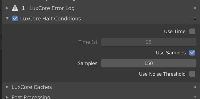

Hey guys. So I was wanting to use the network renderer to render an animation across a few computers I have in my home. The problem is that LuxCoreRender doesn't export halt conditions to the .bcf file. I have the half conditions set how I want them:

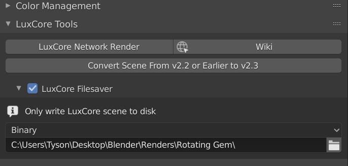

I then export the file using the following:

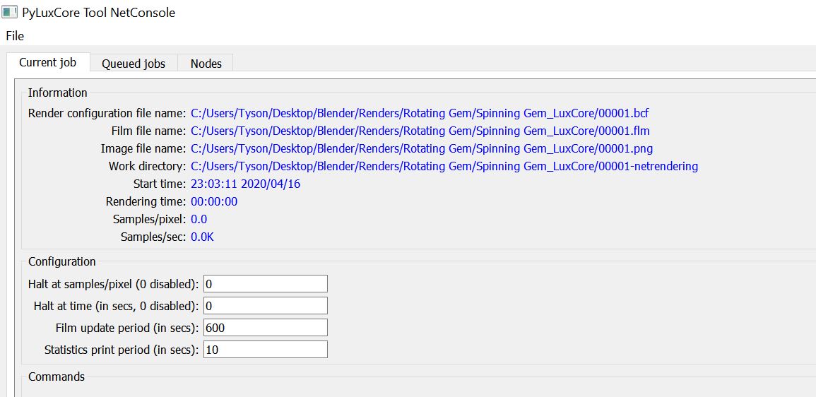

The only problem is that when I load the exported file into the Net Console, the halt conditions don't carry over:
This is problematic because I don't want each frame of the animation to render off into infinity. Is anyone else experiencing this?
Re: Network renderer not exporting halt conditions
Pyluxcoretools should have command line options (like "--halt-spp") to set the halt condition. I assume BlendLuxCore probably isn't aware of this specific option.
