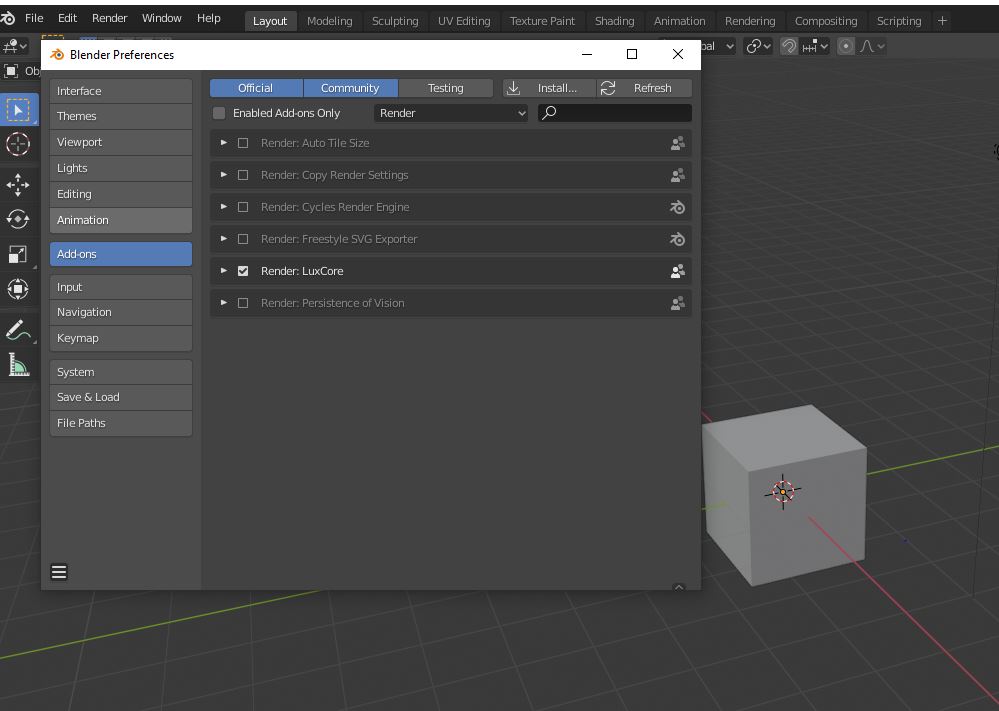

2. Open Blender, Preferences, and install the zipped file (In add ons)
3. In add ons, select "Render: LuxCore"

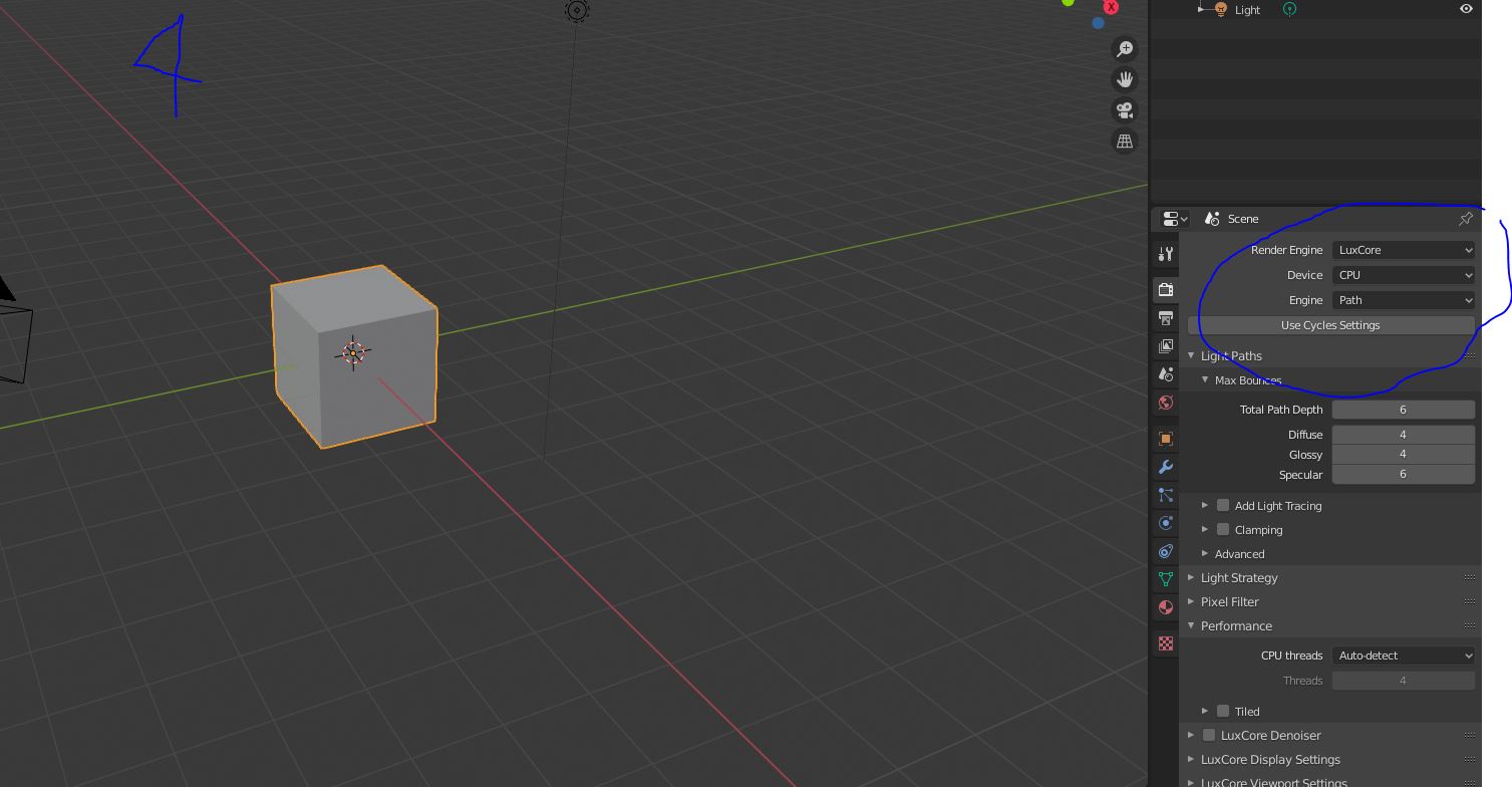

4. In scene select "LuxCore"

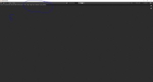

6. I then get no render or anything, just a message saying "Object has no attribute Cycles Visibility.
Please see attached pictures

You need to have the Cycles addon enabled.
Re: Issues installing LuxCore on Blender 2.82a (Windows)
Thanks for the reply! How to I do that? As in the scenes tab on the right hand side? Cheers
Please refer to the Blender manual on how to enable an addon.
Thank you!!! I enabled the cycles in add ons and it worked. Thank you for that means a lot!B.Y.O.B. wrote: Fri Apr 17, 2020 10:12 am Please refer to the Blender manual on how to enable an addon.
