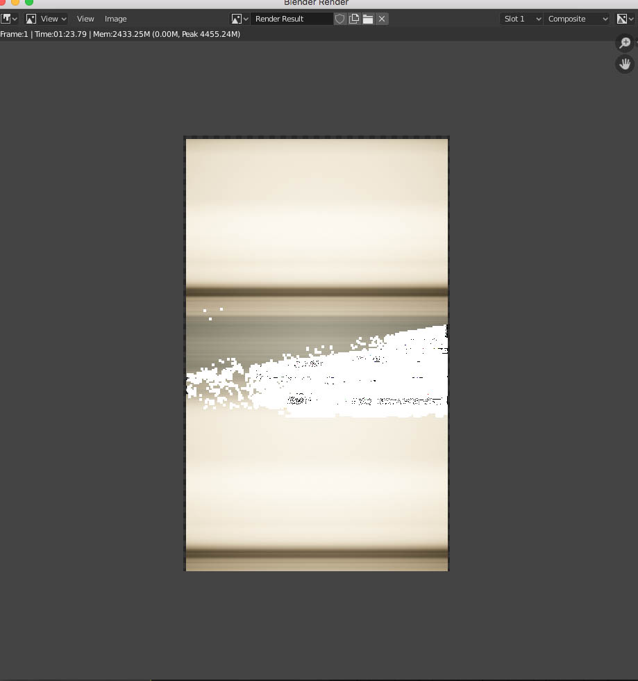

Hi everyone,
i have a problem with denoiser. when i finished viewport render mode, it shows "could not start denoiser:[errno 13] permission denied...Also when i finish final render ( when using BCD ) the denoiser layer looks really wierd. i am using core 2.3 Blender 2.81.16. i am on a Mac High Sierra. is there a solution for this ?

taner candan wrote: Thu Apr 16, 2020 11:15 am Also when i finish final render ( when using BCD ) the denoiser layer looks really wierd.
You should show a picture of the artefacts you observed, and an undenoised render to compare. Ideally you always upload a blend-file with your problems so that the developers can reproduce the errors.

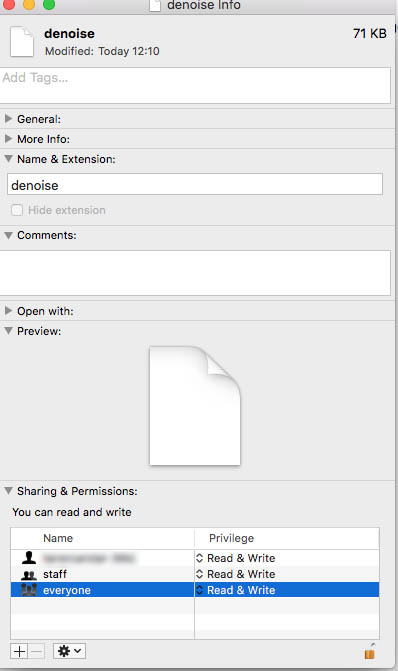

Thanks for your reply,
Here is the screenshot of my denoiser output.
it happens for all scenes. Not only 1 scene. For each scene i have this problem.
i checked the link and i gave permission to the denoiser read and write. But same problem still giving me the same error. than i gave permisson to all blender folder. i do not know if it was a right thing that i made by giving permission to the blender folder.

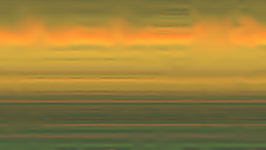

The BCD never worked that well, Oidn is way better.
Here is BCD sample at 1000 spp (16 hours):

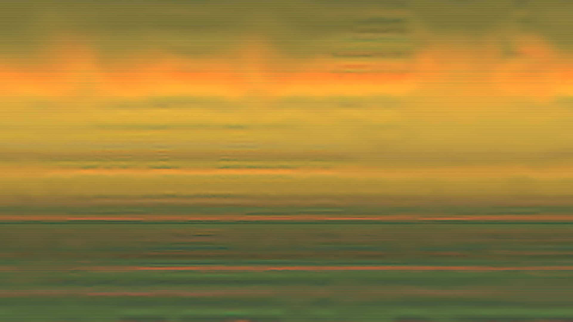

Post by MattRM »
Same issue with the BCD denoiser, below the result. No problem with ODIN. BCD is great (tried it in an other render engine), more longer than ODIN but not bad (depending of the scene and render). Version 2.3 in Blender 2.82 E-Cycles build (same as 2.82 standard build + E-Cycles render)
