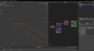

i cant get a working image on a curve
so, i'm trying to get hair cards working, but everytime I put an image on I get an error 'curve' object has no attribute 'use uv as generated' and it wont even render again until the image is deleted out of the shader editor. 2d mapping doesn't work either any ideas?????? please.
Re: i cant get a working image on a curve
This bug has been fixed in the latest v2.4 daily builds. https://github.com/LuxCoreRender/BlendL ... tag/latest
