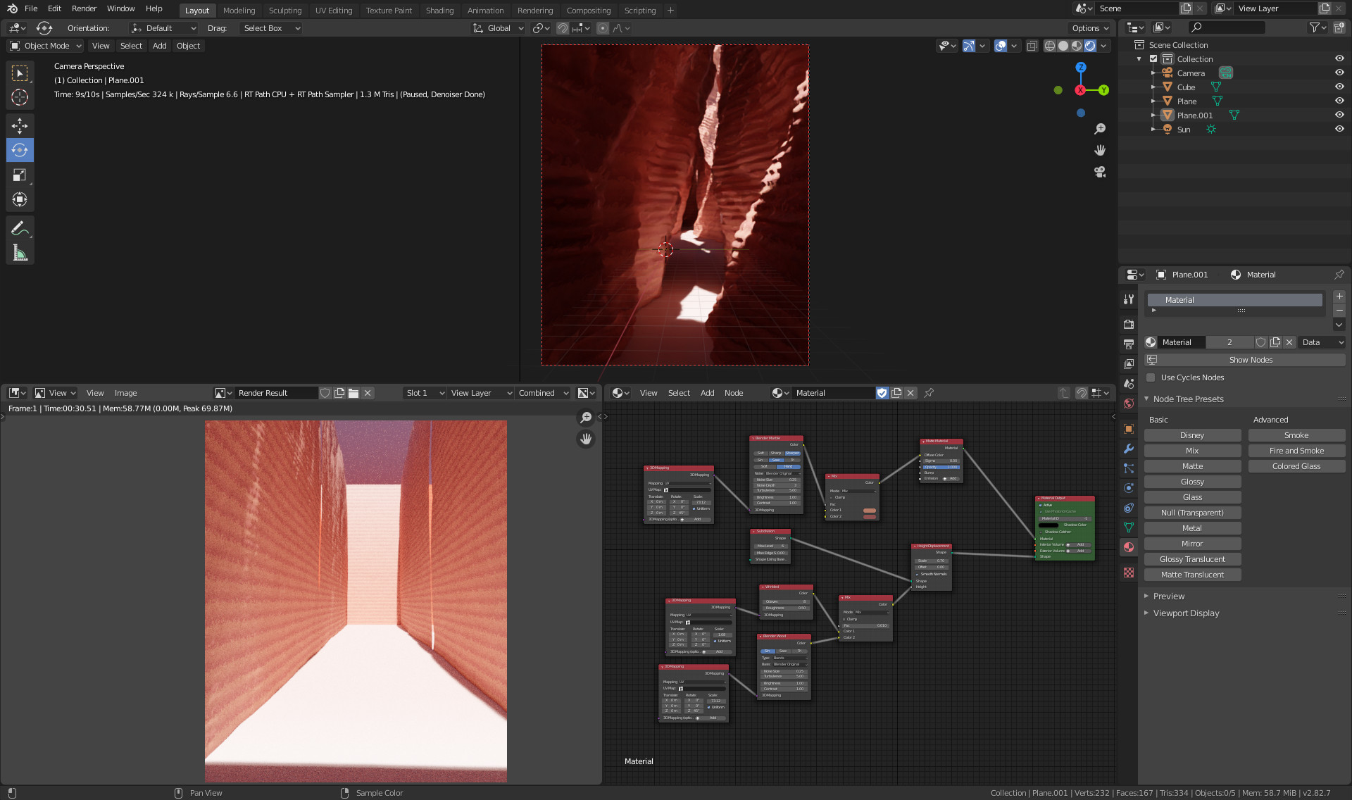

Displacement: mismatch between viewport and final render
Viewport and final are not matching each other.
Blend :
Antelope__cayon.blend
(2.07 MiB) Downloaded 339 times
Re: Displacement: mismatch between viewport and final render
You have to apply the scale on the object with displacement, then multiply the displacement height with the applied scale (i.e. 10 in this case).
Antelope__cayon_fixed.blend
(2.09 MiB) Downloaded 306 times

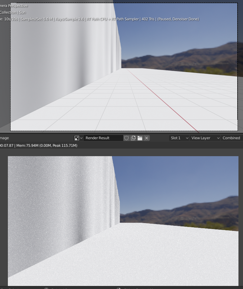

Now it is a mismatch between texture transformation displacement. normally it should be stretched.
antelope__canyon.blend
(2.03 MiB) Downloaded 316 times
final and viewport look identical to me, am I missing something?
B.Y.O.B. wrote: Mon Mar 30, 2020 10:16 am final and viewport look identical to me, am I missing something?
yes you miss. i mean in the viewport displacement doesn't match the voronoi texture stretching. connect the displacement node to see if it match texture transformation.
My bad i didn't select the right mapping transformation mode (Should be UV not Global)
I think there's a bug here.
