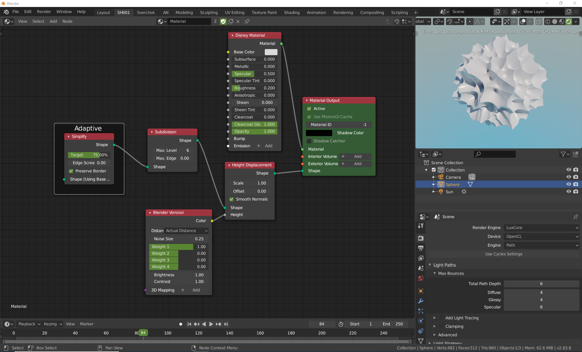

Hi friends need help.can anyone share new displacement node setup.
Re: Displacement material setup
If you need Adaptive displacement , you can use the node simplify
Should the simplify shape one come after the displacement/subdivision? Clarifying for myself as well
It should be to the right of the displacement. The node tree is evaluated from left to right: Base mesh in -> shape modifiers -> output.zeealpal wrote: Thu Mar 19, 2020 4:46 am Should the simplify shape one come after the displacement/subdivision?
