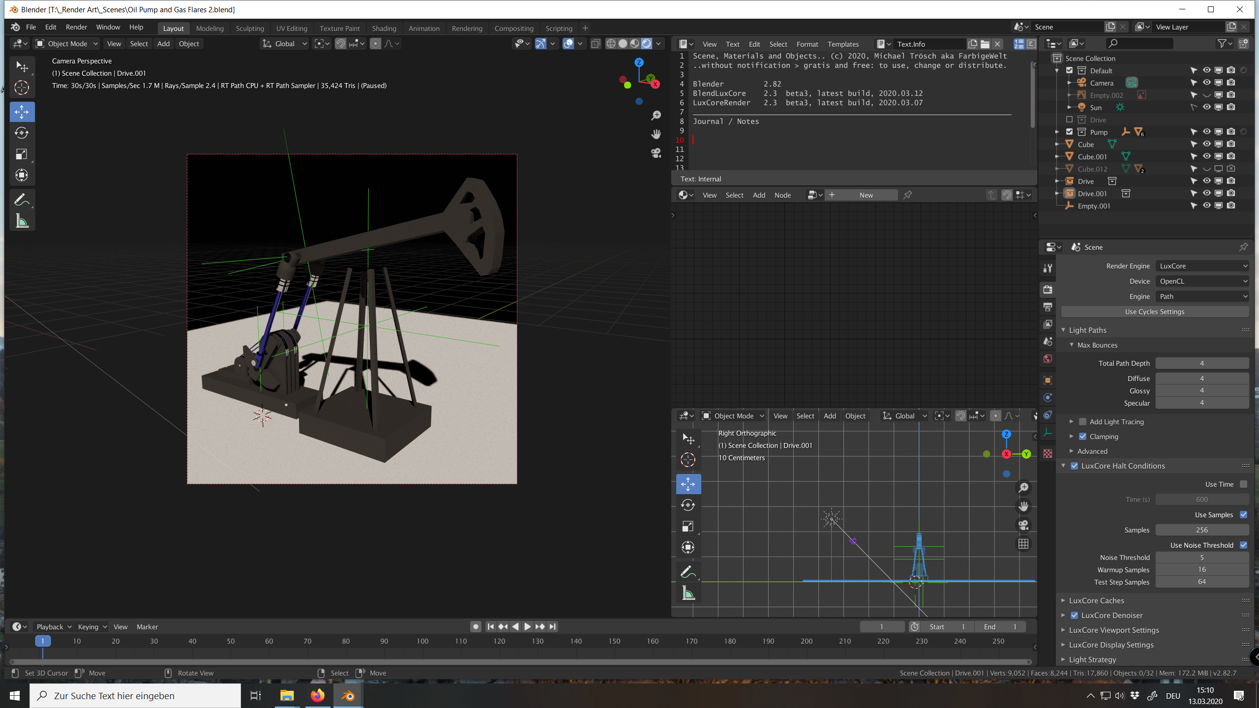

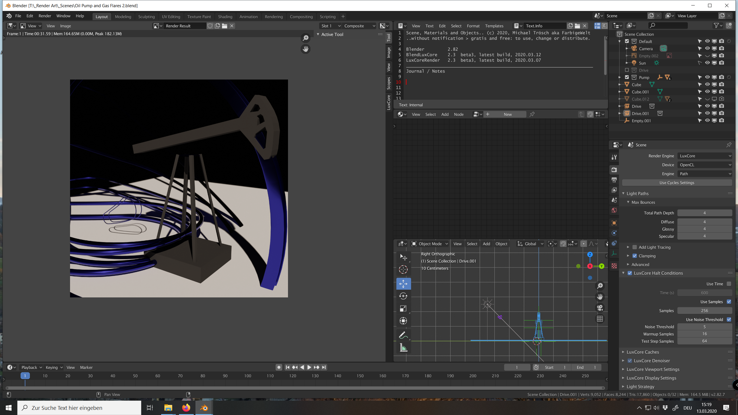

Well, I guess you agree there is obviously gone something wrong...
Blender 2.82
BlendLuxCore 2.3 beta3, latest build, 2020.03.12
LuxCoreRender 2.3 beta3, latest build, 2020.03.07
Please, check scene file and fix the issue.
ISSUE: Collection Instancing: view port okay, final bad

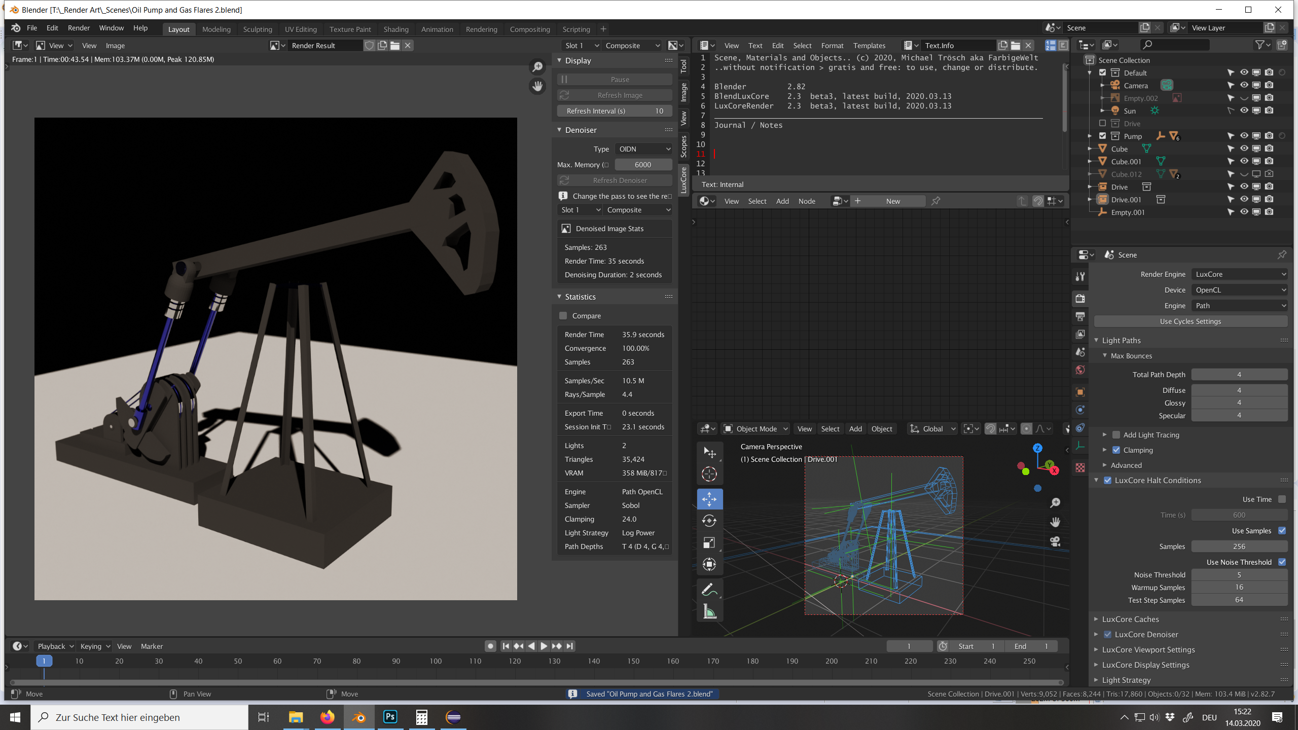

SOLVED: Collection Instancing: view port okay, final bad
Hi B.Y.O.B.
Thank you very much for solving the problem
The issue is fixed in the current latest builds.
As you can see, collections are instanced in final render as expected. Blender 2.82
BlendLuxCore 2.3 beta3, latest build_67a8a70, 2020.03.13
LuxCoreRender 2.3 beta3, latest build_410a62f, 2020.03.13
