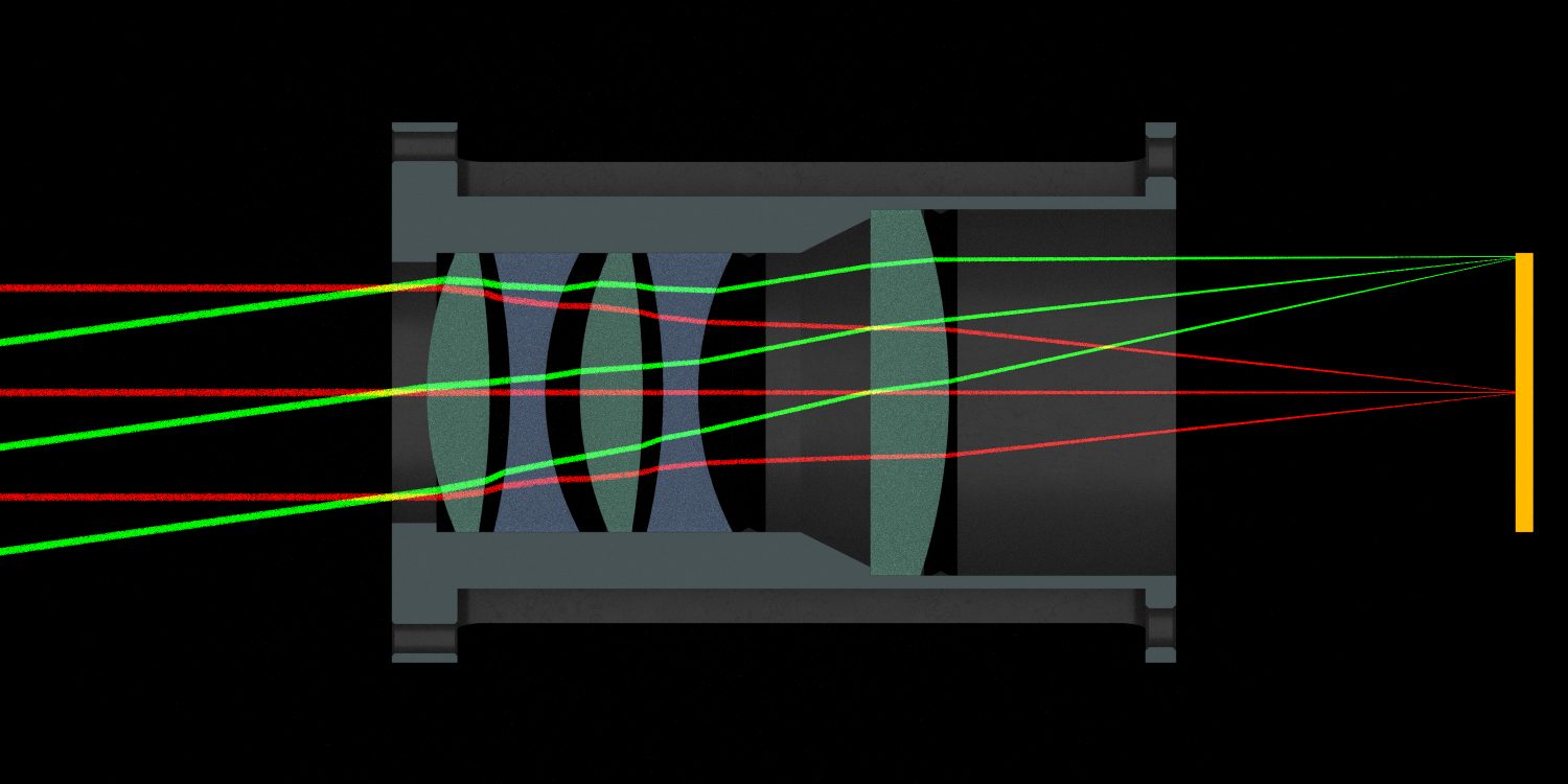

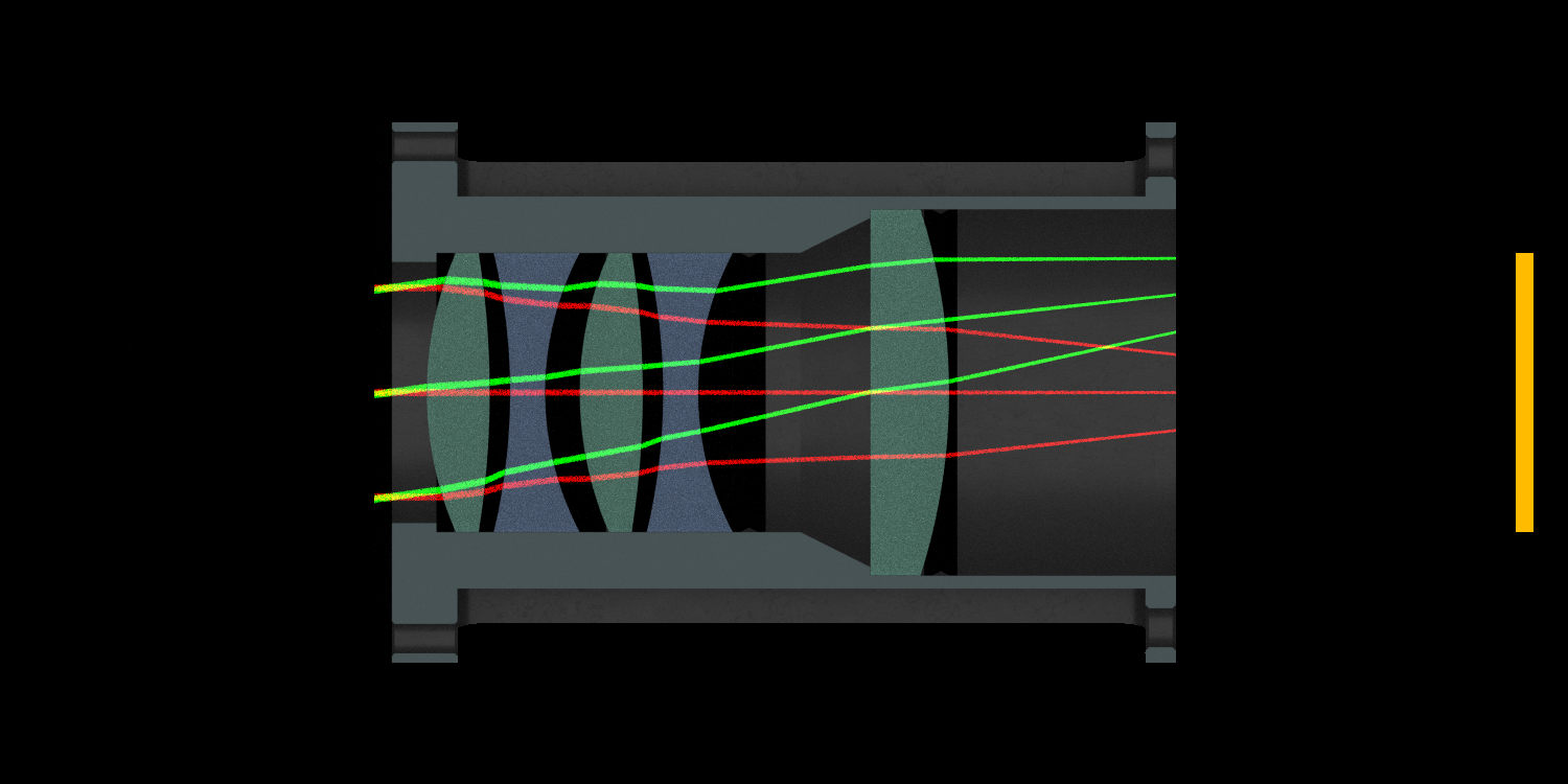

I'm currently working on a visualisation of rays in a lens system, using lasers with homogeneous volume.
I'm trying to do it with a transparent background, but then the rays that are in front of the background get (mostly) cut off. Example renders attached.
Is there a setting for this somehwere? Viewport render doesn't show this behaviour.

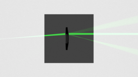

I think I see the problem. I inspected the RGBA values pixel by pixel. The RGB values of the laser beam are in fact there, but the alpha-value remains zero for most of them, and small for the remaining. Thats why when I import it into another programm and add a background, the beam doesn't appear.
Thinking about this, I believe it is correct behaviour. Volumetric scattering in front of transparent probably just isn't easy.

I get it. Volume was just too thin. There I multiplied scattering scale by 10:

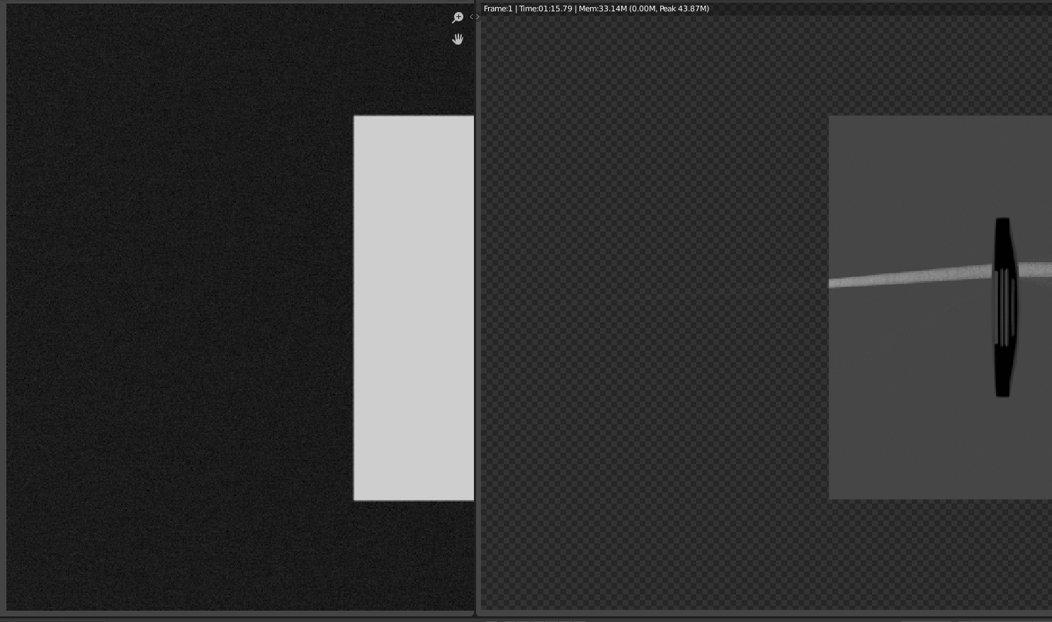

CodeHD wrote: Wed Mar 04, 2020 4:04 pm I think I see the problem. I inspected the RGBA values pixel by pixel. The RGB values of the laser beam are in fact there, but the alpha-value remains zero for most of them, and small for the remaining.
I assume it is the correct behavior: alpha will be an average of all the times the ray pass trough (alpha = 0.0) and all the times the ray is scattered (when the laser is visible, alpha = 1.0). So if the volume scatters the laser 1 out of 10 times, alpha should be equal to 0.1.
Are you experiencing a different behavior (for instance alpha a lot smaller than the expected value) ?

Hence my "problem" (i should have put it in quotation marks before ;) ) is that the beam in front of the intransparent lens barrel is a saturated green, but if add a white background to the image in post I do not see the beam, even though the color values are there. This would be nice for renders of volumetric stuff that you later want to combine with something else.
I just played around with a script that (basically) adds the color saturation or brightness to alpha. Works to some degree, but suffers from noise and white-scattered light from the scene illumination (If only OIDN worked with alpha :P). So it may not really be a universal solution.

CodeHD wrote: Wed Mar 04, 2020 5:57 pm I just played around with a script that (basically) adds the color saturation or brightness to alpha. Works to some degree, but suffers from noise and white-scattered light from the scene illumination (If only OIDN worked with alpha :P). So it may not really be a universal solution.
I think you could just post-process the alpha channel: if (alpha > 0.0) than set alpha = 1.0
Re: Transparent background, threshold level
Dade wrote: Wed Mar 04, 2020 6:30 pm I think you could just post-process the alpha channel: if (alpha > 0.0) than set alpha = 1.0
That won't work, since the alpha is the same over the whole volume.
The alpha is not modified by how much light was received for a pixel.
alpha channel on the left

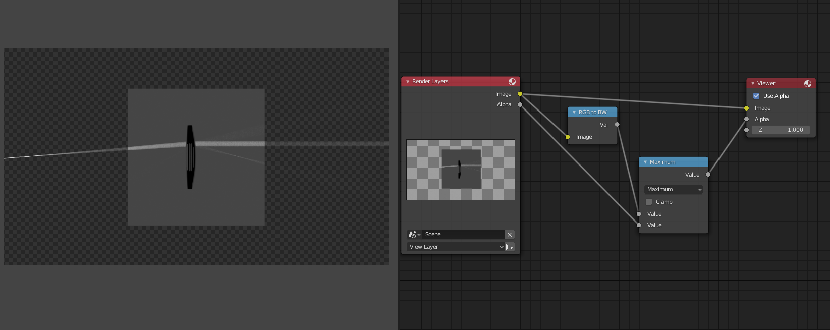

Maybe a compositing setup like this would work?
