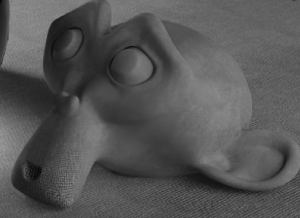

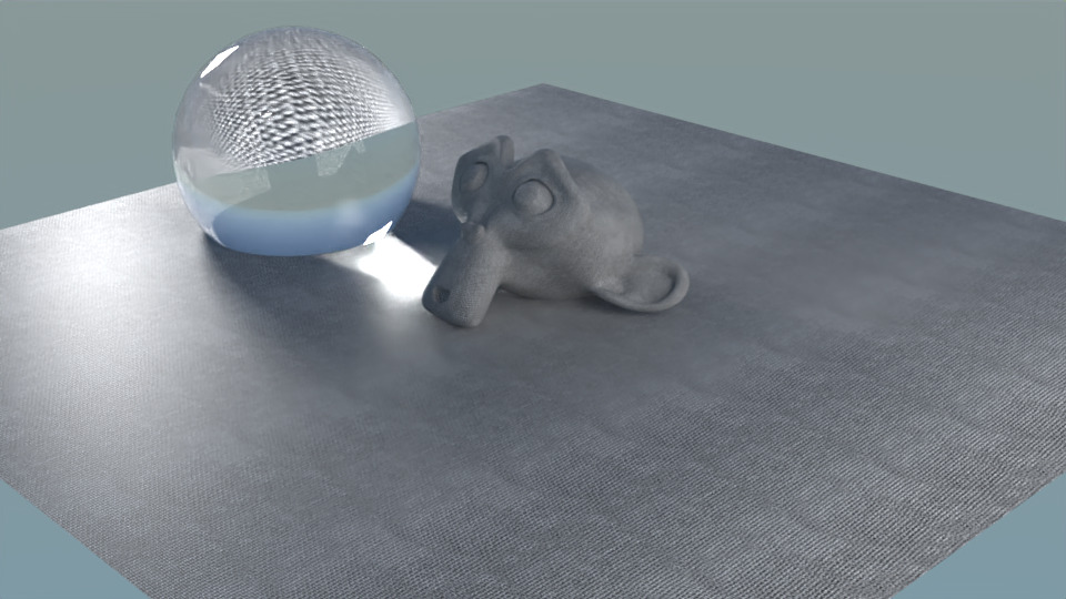

So I found the the result OIDN delivers in Lux is below the optimal result it can deliver.
I've done a video showing the problem and the comparison so you can see what am I referring to, but basically OIDN can go from this:
To this:

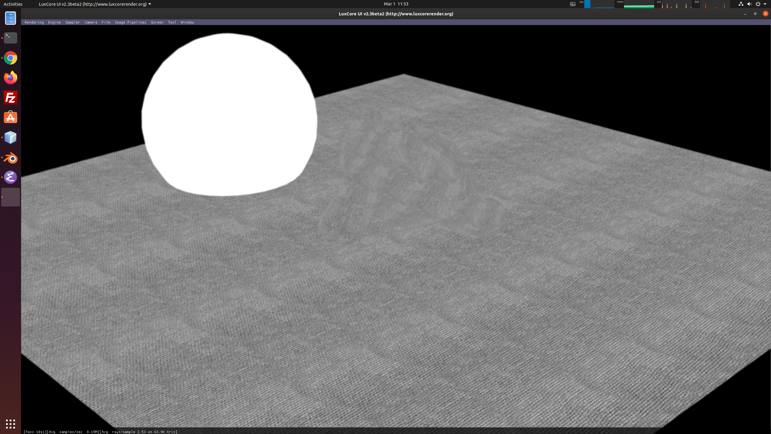

My first candidate for the problem is the blurred ALBEDO pass. Even after 1000 samples is still blurred:

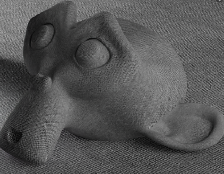

Even disabling pixel filtering (i.e. the sharpest possible render), I end with a quite blurred render:
This is unavoidable as there aren't simply "enough" pixels to carry the information.

It tested this idea, this is a 960x540 with 100 samples/pixel:

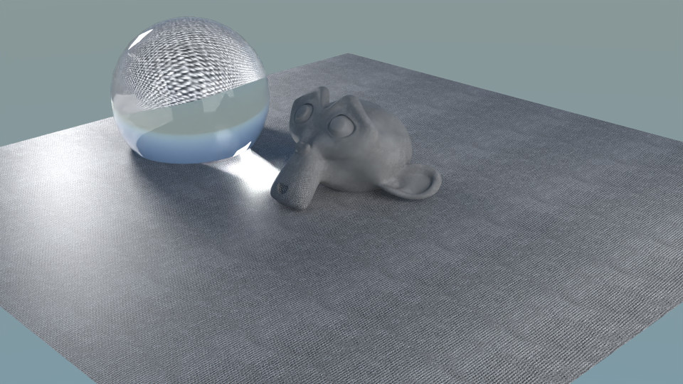

And this at 1920x1080 with 25 samples/pixel and than scaled down to 960x540:
It is a lot better on the plane but worse on the Suzanne ... this stuff is really unpredictable ...
I guess it should be rendered even at higher resolution (with less samples/pixel).

The way of improving the result in cycles is denoising each pass separatedly, you have the exact technique in the compositing of the blend file I gave you (the same I show in the video)
If you compare both Albedo passes they are kind of similar, however the Cycles Albedo contains two things, the reflection/refraction and the fresnel effect, so it’s not a pure Albedo.
The other big difference is the Denoise Normal pass, it seems to me it’s a Normal pass in screen space.
In the end the key in cycles is to denoise each pass separatedly, but the same does not work in LuxCore, I imagine that it’s because the different AOV organization, which I don’t understand too much, but I would assume that it’s because how LuxCore works, for example the Diffuse pass is entirely black, not sure why, when most of the info it’s in the specular pass, not sure why either.
