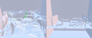

HI there.

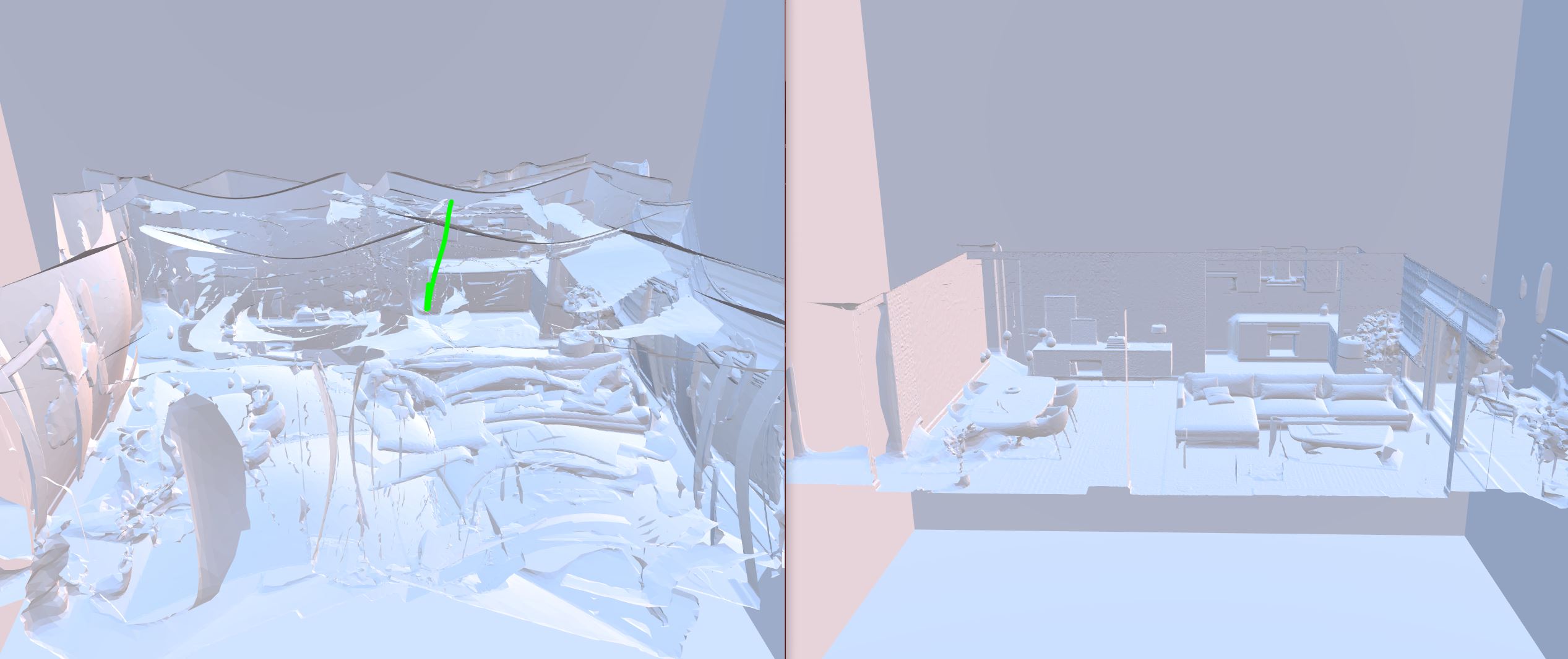

We are using the Z-Depth for the support of Layama app in Blender/LuxCore.
But it seems the Z-Depth channel is acting werid, in this picture you can see an Eevee (Left) vs LuxCore (Right) output, I don't understand why is there such a big difference in the Z Depth output:
This leads a problem in the geometry calculation for the webapp, Left is LuxCore Z-Depth result, Right is Eevee Z_Depth result:
Some ideas on why may this be happening?
Some setting?
Thanks!
Re: Problem with Z-Depth output
LuxCore Depth AOV is the distance from the film image plane, may be Eevee uses something different like distance from the camera position :?:

Yes, I think Cycles/Eevee give the Z pass from the camera position, is there a way to counteract this?

juangea wrote: Wed Feb 26, 2020 12:45 pm Yes, I think Cycles/Eevee give the Z pass from the camera position, is there a way to counteract this?
I can add a new AOV with this information (in v2.4). However I would further investigate the topic of Cycles/Eevee Z pass just to be sure how they work.
I don't think there is a viable work around at the moment aside form using the (first hit point) Position AOV and doing the math (<position> - <camera origin>) :idea:

I think we will be able to use the POSITION AOV since it's World Position, instead of the Z-Depth, so we are fine :)
But could be a good idea to have a Z-Depth, in the future, that measures the things in the same way as Cycles/Eevee, just ot make easier the life of compositing people in mixed pipelines or with already defined pipelines and comps.

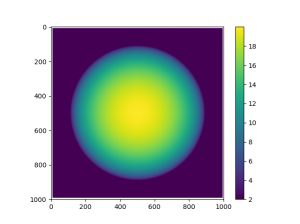

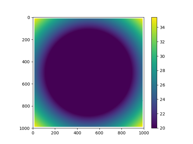

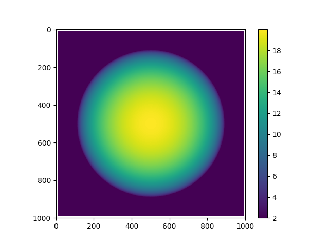

I've been investigating the depth AOV a bit after yesterdays discussion in the radio-modelling thread.
After far too much unneccessary checking, I've noticed the following (blend-file attached for a test setup - camera at centre of a hollow sphere carved into a cube):
With LuxCore standalone, I get distance from the camera plane for ortho camera:
and distance from the camera point with perspective:

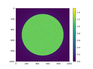

Rendering and saving from Blender, however, I get something quite different:
By my observations it is some factor times Dot(RayDirection, SurfaceNormal)^3
The World position AOV gives exactly the same output btw.
I tried following it through the code myself, but in blendluxcore i stalled at engine/final.py, _add_passes(), where I can't find the definition of eninge.add_pass(), also not in LuxCore. I assume it is part of pyluxcore? Or did Visual studios search just fail me?
Am I missing some switch in Blender here or does it really parse a wrong output?
