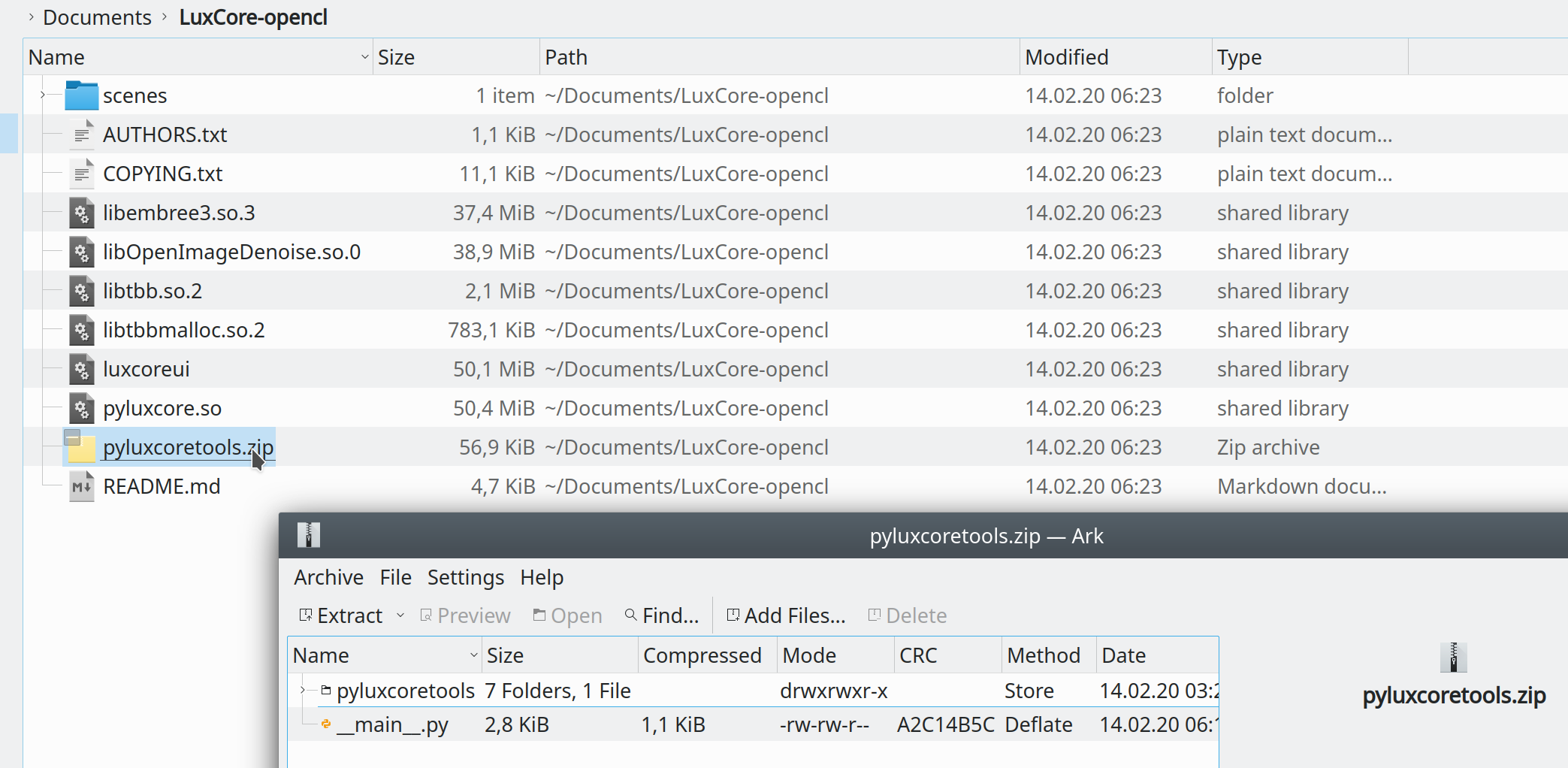

It's small file, not sure how to run the network node.
The entire LuxCore-opencl.tar.bz2 is only 70 MB, same like Azure auto build.

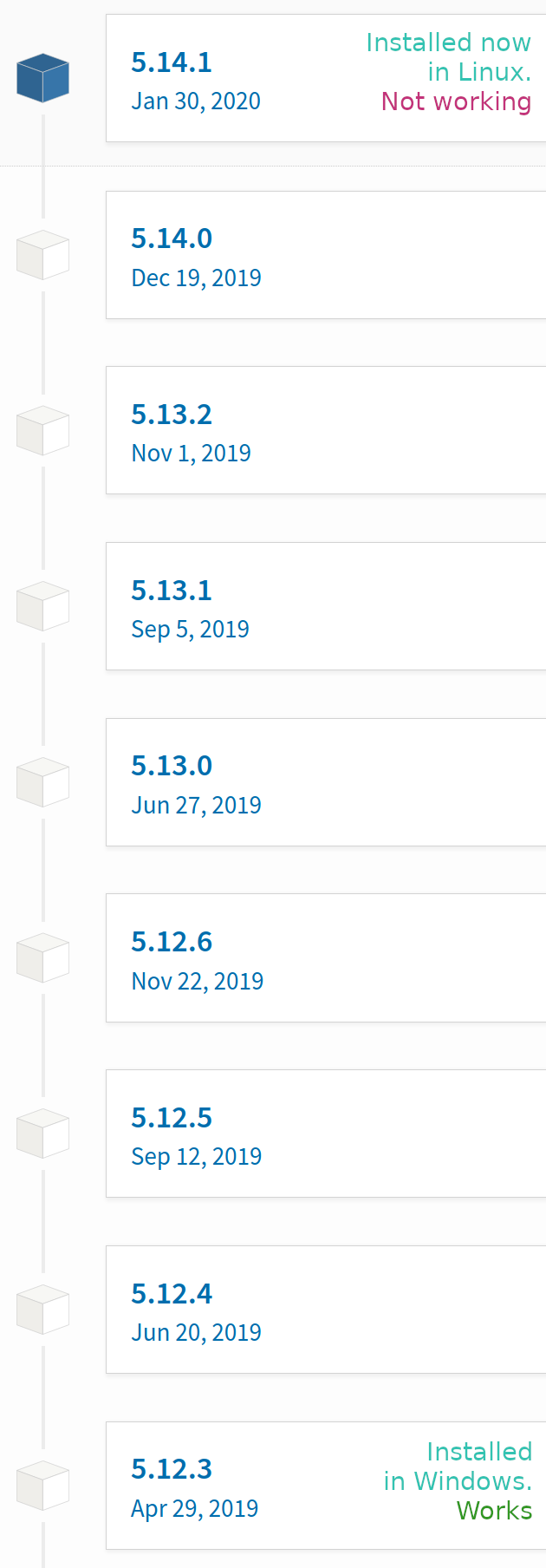

It's the latest pyside2 5.14.1
I will check the older versions.

Post by Fox » Sat Feb 15, 2020 4:05 pm
I went to the pyside2 version that worked in Windows (5.12.3).
Still same error:
TypeError: 'PySide2.QtWidgets.QWidget' called with wrong argument types: PySide2.QtWidgets.QWidget(MainApp)
