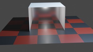

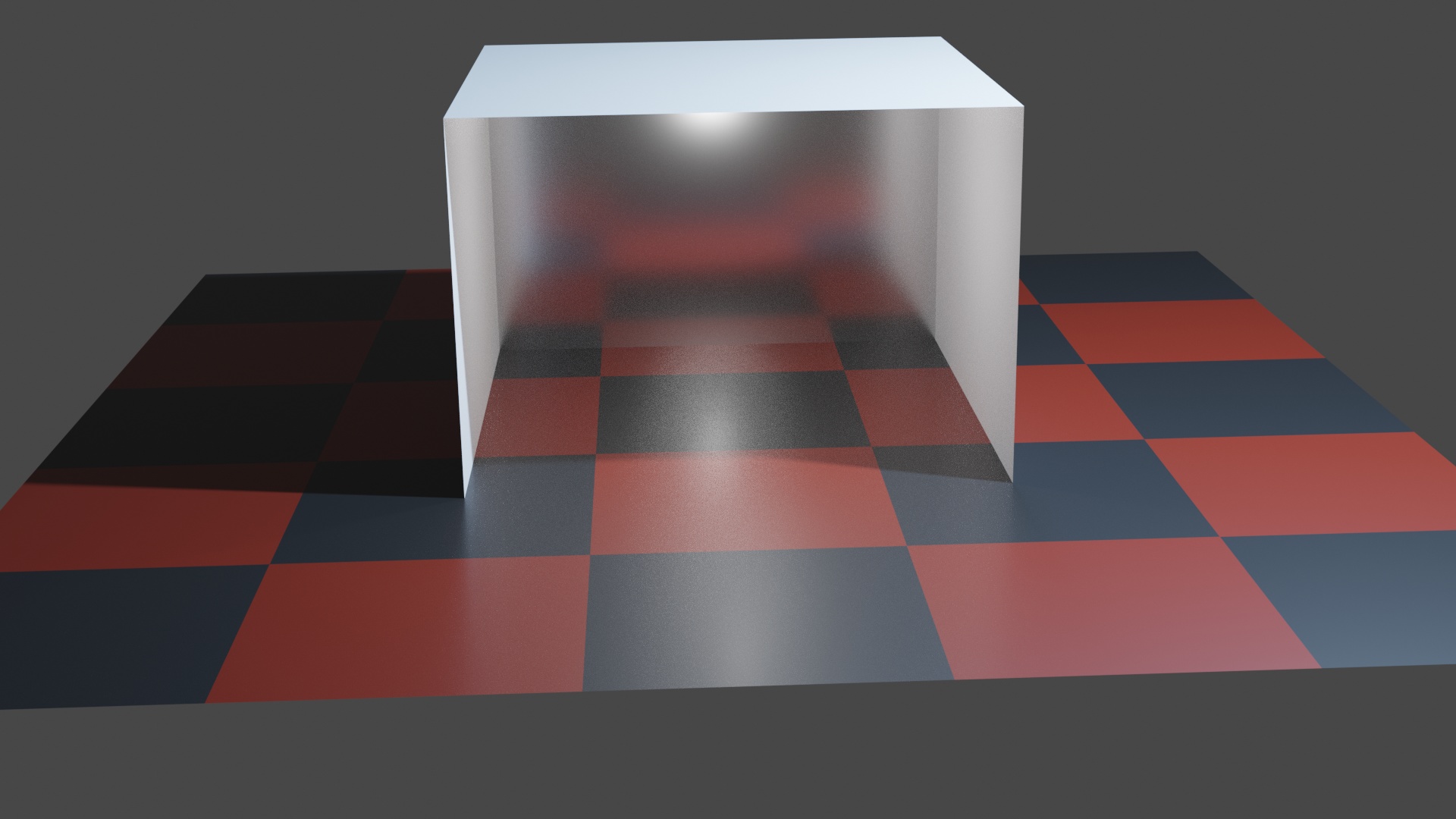

I'm back with another interesting topic that can lead to the need of less samples per render.
This is Dithering for the Sobol sampler, it could be something kind of "easy" to implement (please keep in mind that I use the "easy" term very carefully because I'm not sure if it's actually "easy") but it can benefit A LOT the render results and it could help A LOT also with denoising quality.
I will present here an example, in this case and for the shake of making the effect more visible I will be also using Scramble Distance in Cycles, but the effects of dithering are good without scrambel too.
Here I present two pictures, the first one is the standard Sobol pattern of cycles at 500 samples:
The second one is the exact same scene with the exact same amount of samples, just that it renders 3 seconds faster and delivers a far better quality under the same amount of samples:
Now the better sobol pattern ends up giving less visible noise (or subjective noise) and a far better picture to look at.

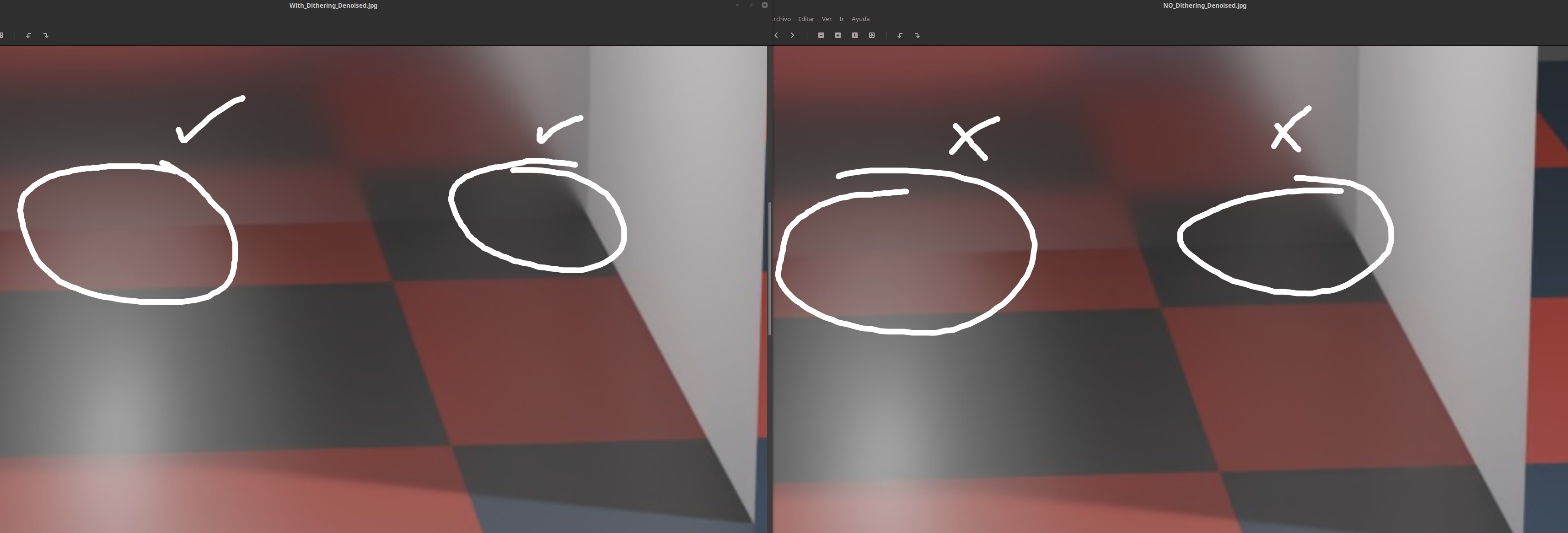

Also the denoiser behaves way better, here is the example (There is a bit JPG compression):
Here are both denoised pictures:
NO Dither version:
DIther version:
