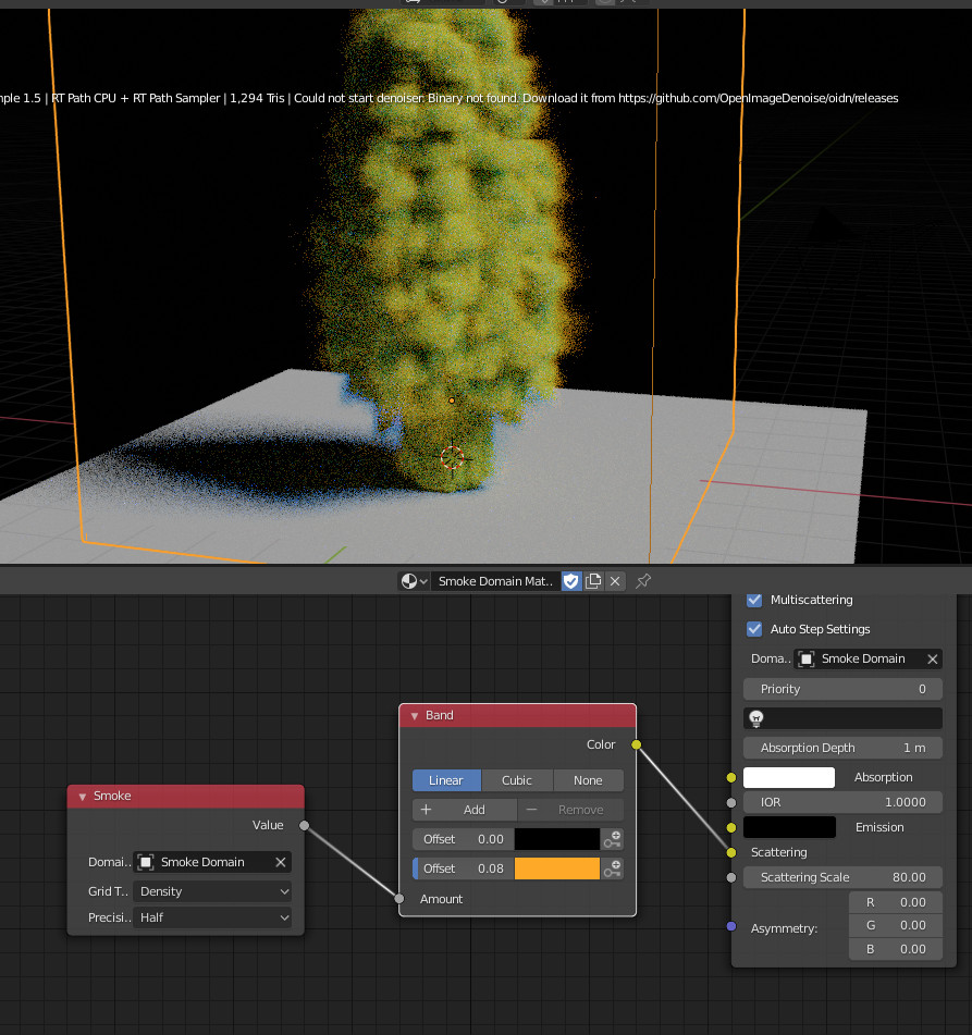

Post by Sharlybg » Wed Jan 22, 2020 1:45 pm
My result is not good look the blue color down.
Posts: 3623
Re: Smoke and volume
Post by B.Y.O.B. » Wed Jan 22, 2020 1:48 pm
If you scatter one color more than the others, the rest will pass through unscattered and create this look. It's the same as with the sky: blue light is scattered, the rest passes -> sky appears blue and sun appears yellow/red (the effect is stronger when the sun is near the horizon, since the distance through the atmosphere is greater).
I would recommend to use the absorption color instead and leave scattering color white.
Also can we move from pointer to full node display when we add a new volume ?
Yes, the preset could be changed indeed.

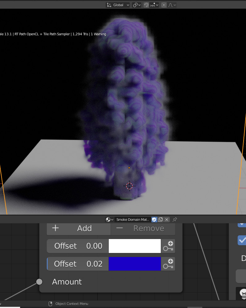

Post by Sharlybg » Wed Jan 22, 2020 2:49 pm
i had tested Absorption and was not very conviced by the result :
Posts: 3623
Post by B.Y.O.B. » Wed Jan 22, 2020 3:09 pm
Have you done a longer render where the noise is gone?

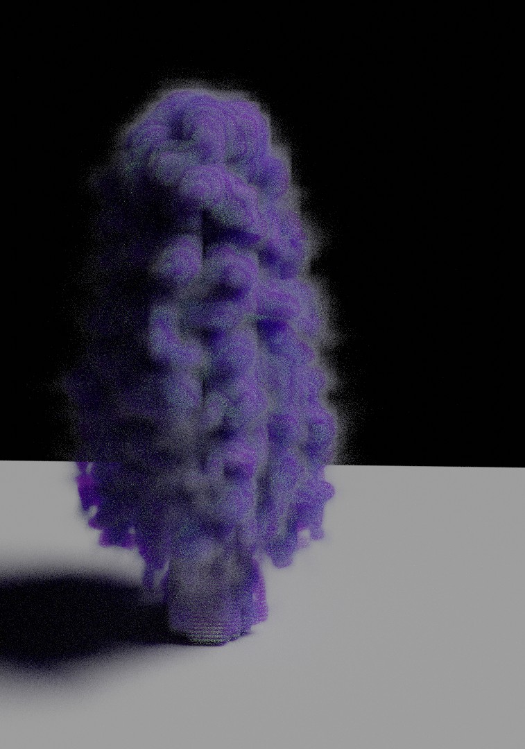

Post by Sharlybg » Wed Jan 22, 2020 3:26 pm

Yes and the color output (purple) doesn't match my (Blue) input and i also get this gey smoke on top of purple one :

You are using RTPATHOCL, how does it look with PATHOCL ?
Posts: 2082
Post by Sharlybg » Wed Jan 22, 2020 4:17 pm
Dade wrote:
Wed Jan 22, 2020 3:43 pm
Look the same :
Posts: 3623
Post by B.Y.O.B. » Wed Jan 22, 2020 5:06 pm
That's RT as well, you need to start a final render instead.
You could try to change the smoke precision from "half" to "float" and see if that helps.
Posts: 2082
Post by Sharlybg » Wed Jan 22, 2020 5:26 pm
same story CPU final render float :
