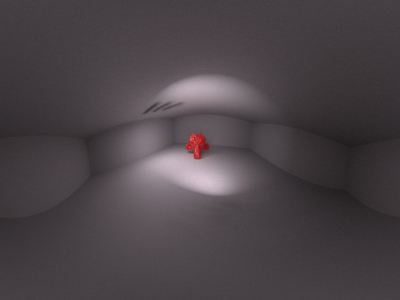

We have a Environment Camera (a 360 panoramic camera):

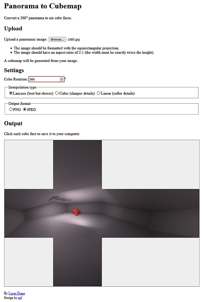

And then convert it with 'Panorama to Cubemap' online tool in an instant...
Here's even the source code: https://github.com/jaxry/panorama-to-cubemap ;)

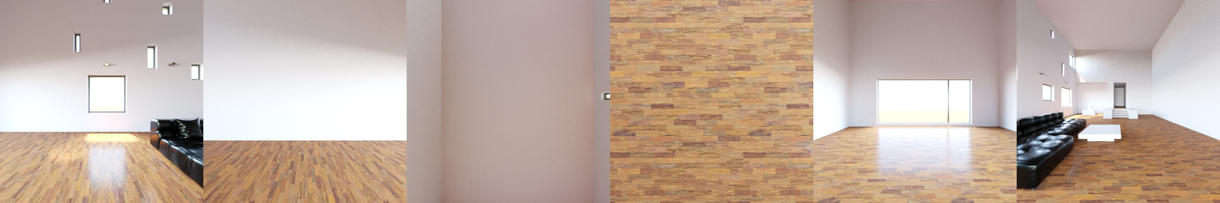

PS.
& This one also saves as .hdr
online: https://matheowis.github.io/HDRI-to-CubeMap/
source code: https://github.com/matheowis/HDRI-to-CubeMap
