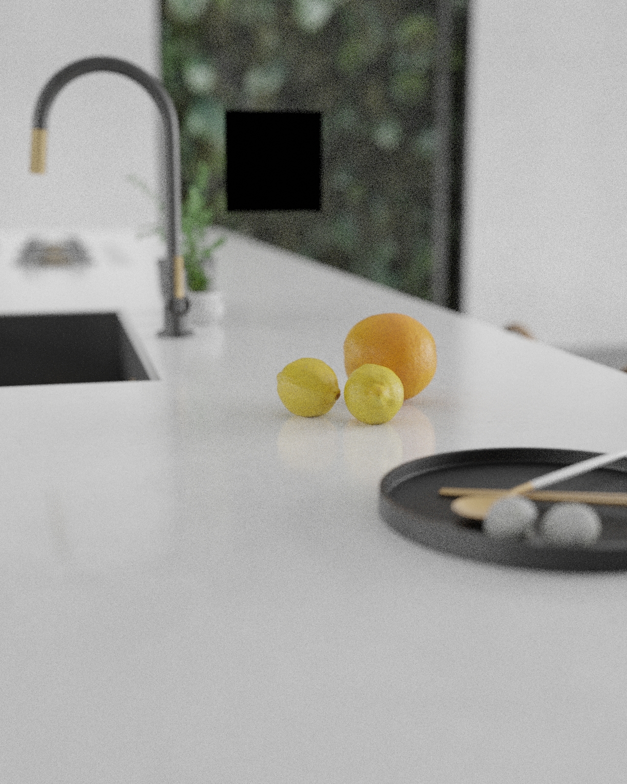

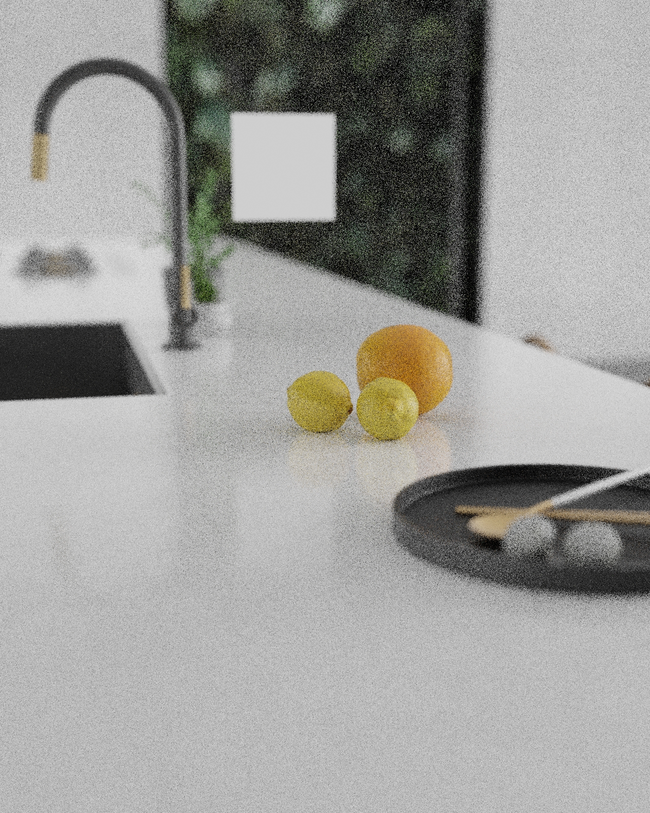

Post by lacilaci »
Nested linked collections will disable new lights for opencl
opencl
cpu
Any idea how to troubleshoot? Why would this happen and why only new lights
when I deleted every object from scene (I kept all lights) suddenly the black light started working...

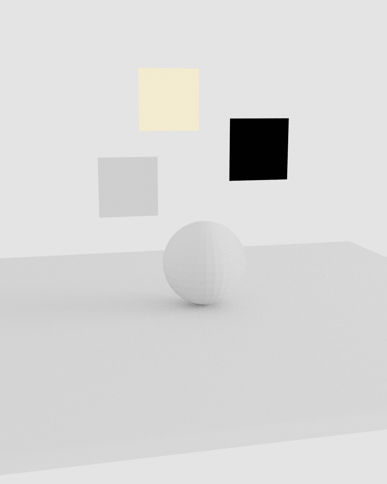

B.Y.O.B. wrote: Mon Jan 20, 2020 10:44 am I can't replicate the problem here, can you upload a small scene showing it?
Yes, here is a scene.. and it even gets weirder where all lights should look same but one is yellow, one black and other one correct..
addlights.rar
(926.75 KiB) Downloaded 215 times
in the master scene (lights.blend) link the lights_linkme.blend - as a collection, don't link objects
Make sure the linked collection is nested in some existing collection in the scene.
Then if existing lights work, create new one and place it so you should see it and watch if it becomes black.. or whatever color
In this scene cpu is disabled in performance opencl resources, so you should use only opencl, cpu should work as expected
these are all the same lights,(top to bottom) one created first, other one after the linking and last one as a copy of the one created after the linking...

This is likely to be related to https://github.com/LuxCoreRender/LuxCore/issues/290, something I have fixed today :idea:
Re: Lights being ignored by opencl
Dade wrote: Tue Jan 21, 2020 2:38 pm This is likely to be related to https://github.com/LuxCoreRender/LuxCore/issues/290, something I have fixed today
Indeed, looks fixed to me.
