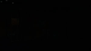

Maybe it's only on my side | W10, B281a, latest LuxCore 2.3beta (9addec117) | :? So, as mentioned in ENV cache persistance thread,
... There are differences between CPU vs OCL :?
Using OCL:
A. Glass produces brighter caustics (refractive) /// Notice darker shadow with CPU
B. Metal is missing reflections
& here's .blend ready to be checked. Issue also occurs in the viewport, just switch engines.
HDRI "Barcelona Rooftops" from sIBL archives included

Confirming the fix. Working correctly now.
Quick comparison gif:
Note:
The difference in rendered image between OCL vs CPU is really minimal now, basically just a difference caused by sampling (tested with Sobol @ 500 samples).
