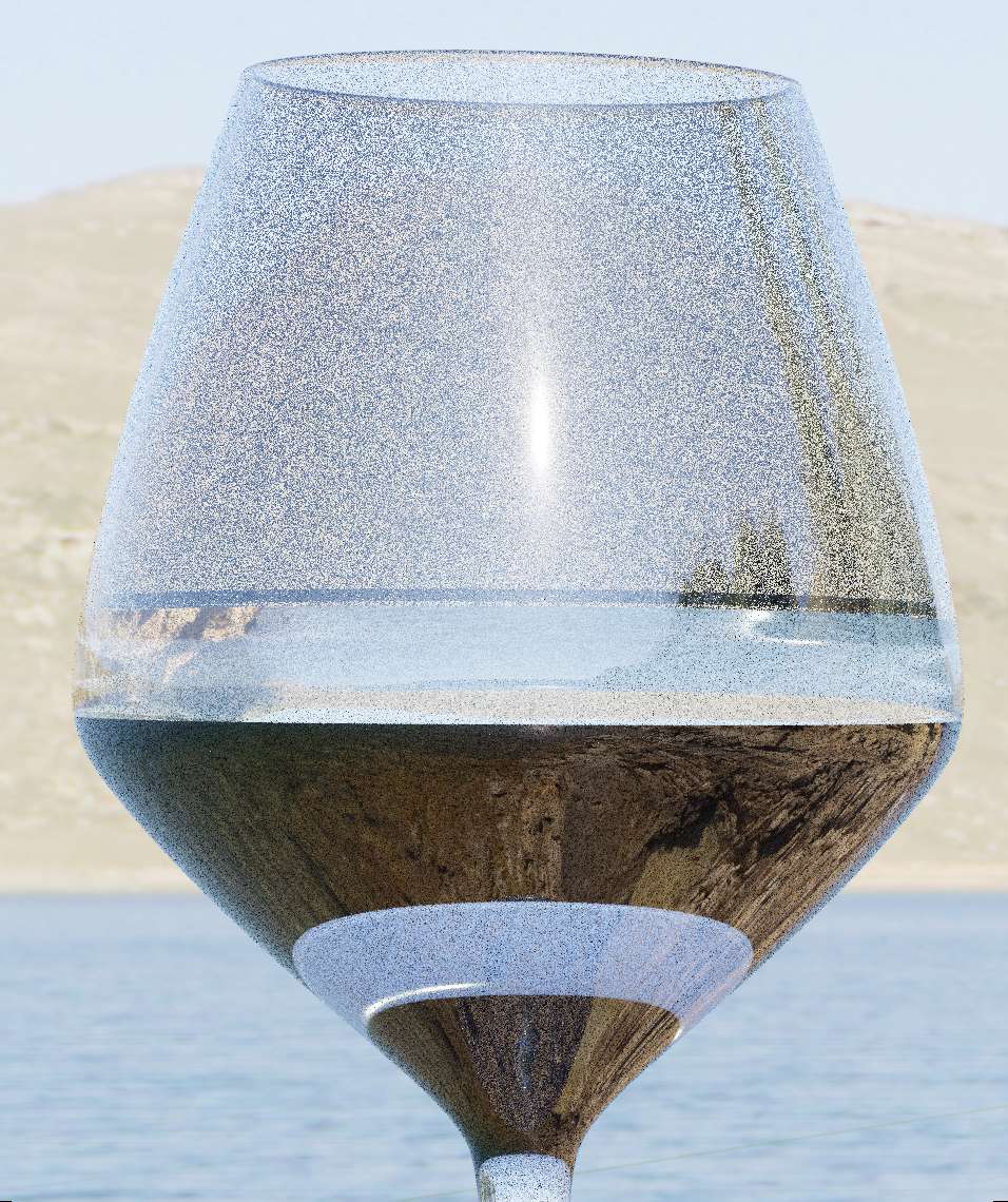

Any word on the addet transmitance features for disney?
Even with latest shadow tricks, proper volume for liquids on glass gets super dark unless liquid is "architectural"(and even then it's affected by glass, see attached images). Some cheap sss in disney could be useful for these (and for skin, etc..)
here:
shadows are disabled (set to white, in both) yet volume always struggles to get some proper lighting. I assume this is correct behaviour and I simply need fake/simple sss as in cycles or wait forever and use caustics maybe...?

Volume on it's own kinda works, but it has to have null as material (so just volume is used)
The moment any glass is introduced it goes dark...

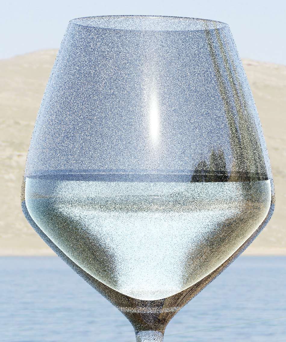

With rough glass it's not dark, but you still need GPU or 2.
Here 10 min on older cpu, this should be 1 min on gpu.

hm.. rough glass kinda helps if I disable glass shadows completely... but without any shadow at all it kinda looks weird in scene

Post by lacilaci »

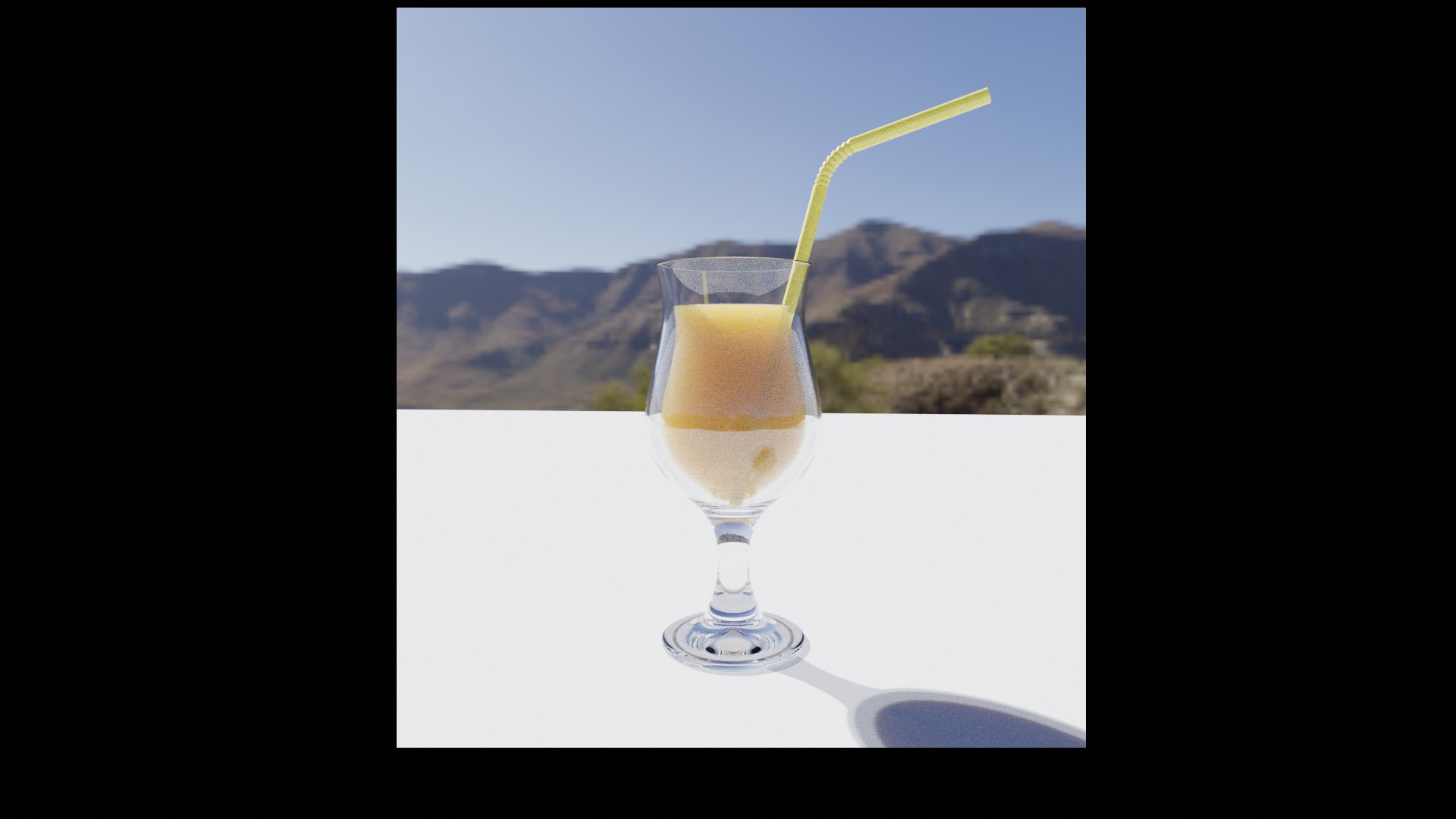

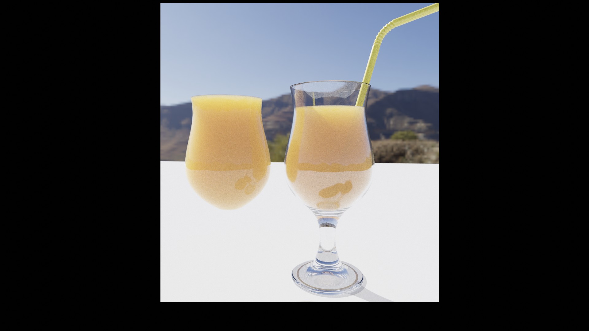

I can kinda get it correct looking when making the juice smaller...
it only get's darker when juice mesh penetrates glass mesh
not touching glass
filled glass(with a bit of juice mesh going into glass)
maybe this could be fixed?
for now, the only way that I can get correct looking volume in glass is making the liquid just a very little smaller than the inside.
This will of course break how refraction works on the glass edges. There has to be a way to fix it when it's inside glass mesh (volume priorities don't do anything for this issue, I tried...)

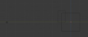

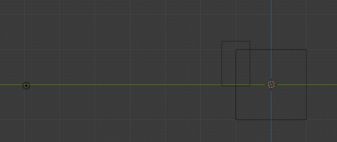

I have set up a simple test scene with a slice of glass and an overlapping volume cube:
The glass has zero reflection, 100% transmission and 95% shadow transparency, it renders as expected:
Try to set up a scene like this one for checking how/if it works. Once you have the result you want, you can go back to the real world scenario.

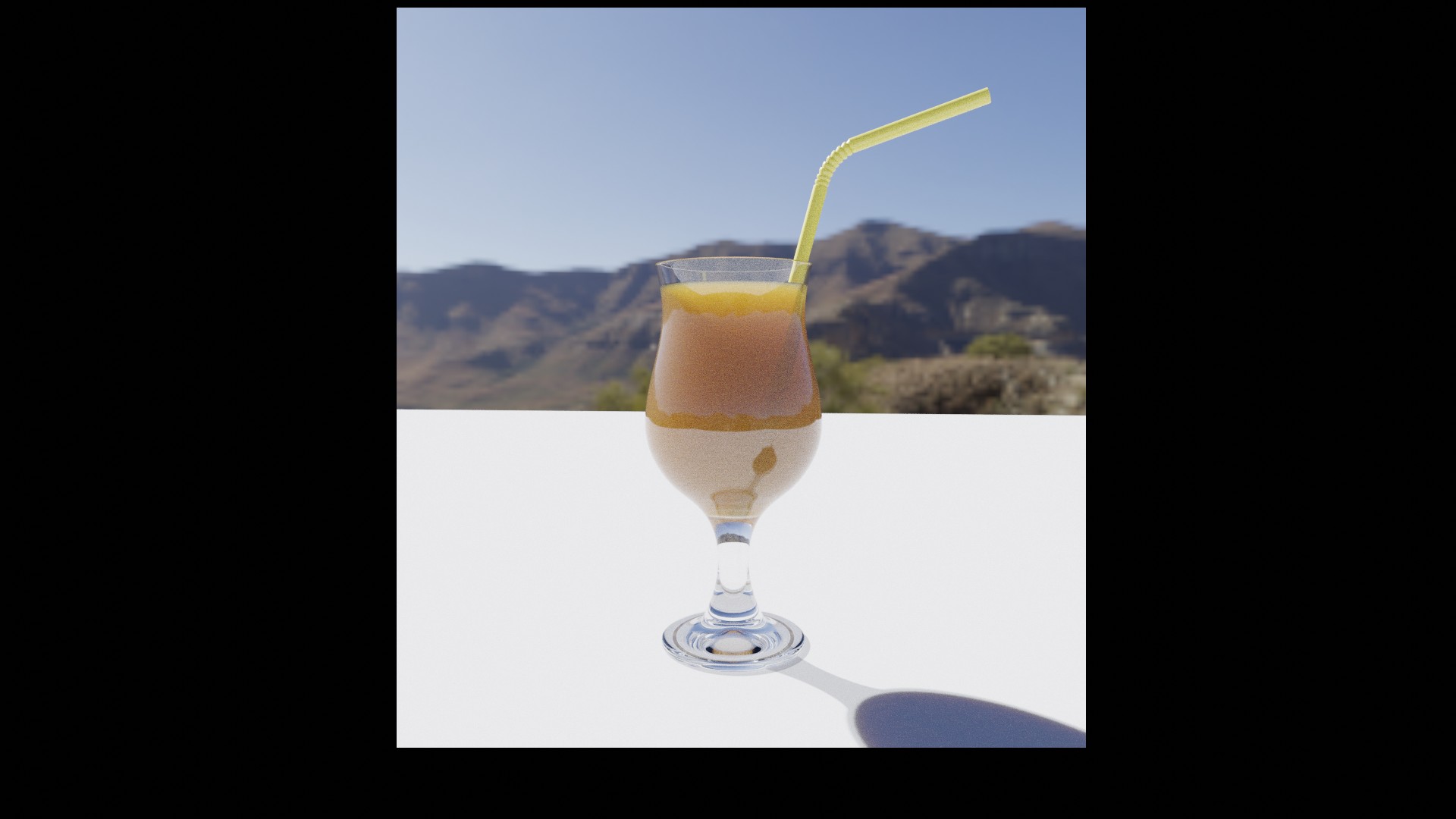

There are some volume priority anomalies with non overlapping volumes.
When i use priority 0 for all,
or i use 0 for world and 3 for glass and 4 for juice,
then it looks like that:
But in case of 0 for world and 4 for glass and 3 for juice,
the outcome is different:
