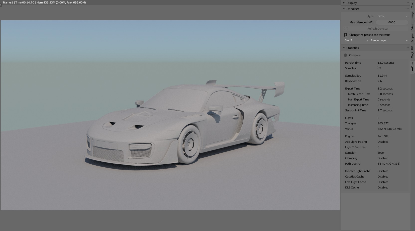

and another thing I noticed is, that without "/ cuda" option enabled (19.05.2020 16:12 CET) & previous builds compiled & ran instantly on GPUs :o
Here are pyluxcore.pyd & luxcoreui.exe for windows to test and see... WTHIGO
https://mega.nz/file/JQhjhYqR#h2vqkpQKQ ... DuC_H_o1Jo
Although it is baffling, it's JUST AMAZING (as it used to be) :shock:
BlendLuxCore stats w/ Halt on 10s / resolution: Full HD (1080p)
CPU AMD 1950X (10s Halt = 32 samples, 6.1 M Samples/Sec)
GPUs GTX1070 & Q M5000 (10s Halt = 69 samples, 11.9 M Samples/Sec)

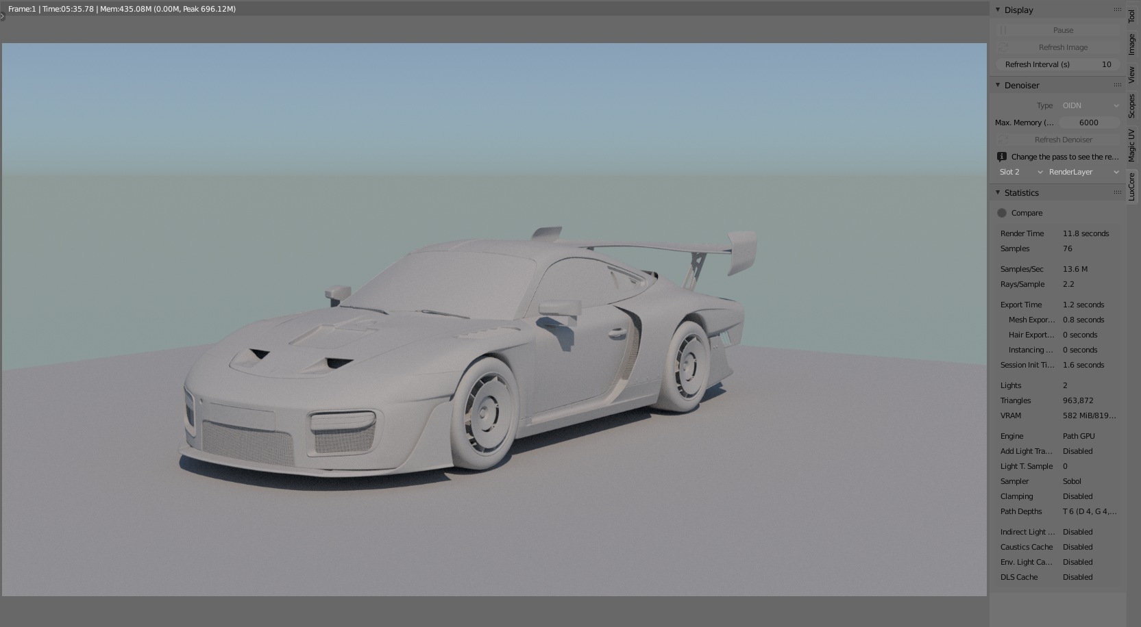

But when I switch to latest "/ cuda" enabled build... i can't find the patience to wait for compiling to end :evil:
oh, why :roll:
GPUs_CUDA... 5:35.78s later (10s Halt = 76 samples, 13.6 M Samples/Sec)
In such way I prefer "standard" build oppose to "cuda" since my workflow relies rather heavily on fast iterations (look dev) and not on faster final render. So in the end, re-compiling for every "drastic" change takes much more time - even a whole day when all iterations are summed up - combined. CPU comes in handy then, but this experience makes me feel sad, disappointed.
From the looks I guess OCL is way faster to compile (NVidia) so basically, what I wonder now is - Would it be possible to have a "switch" between this options? ;)
Re: Windows Build FAILED
I assume you have the OpenCL kernel already cached while the CUDA version is not. Anyway, it is one time compilation in both cases.

Anyways, it compiled almost instantly with "Cycles Settings" and was then moved to Blender 2.83beta where was very responsive (at time I didn't realized I had build "standard" OCL version). So where are caches stored, so I can clear/ delete all & make proper comparison?
And it would be great, if both versions could be built.
Also because now, after both were compiled (using different LuxCore commits) in Blender 2.83 - closed & restarted - CUDA is always slower.
With OCL the samples went up to 75, with 13.6 Samples/Sec & CUDA slowed down to 71samples, 12.7 M Samples/Sec. True, the scene is plain & simple, but nonetheless...
