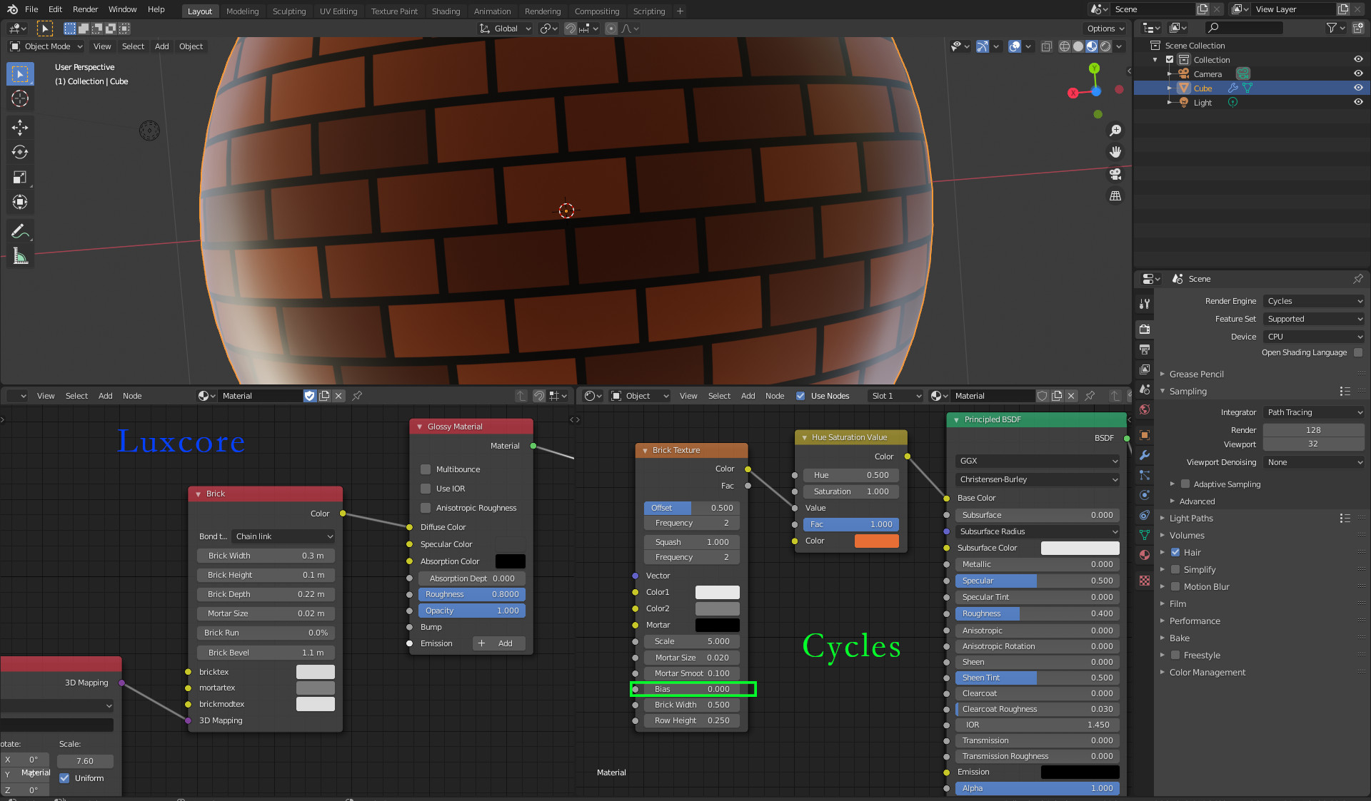

Any way to randomize color in procedurale brick texture in blendluxcore ?
The cycles one come random by default i can't redo it in blendluxcore.

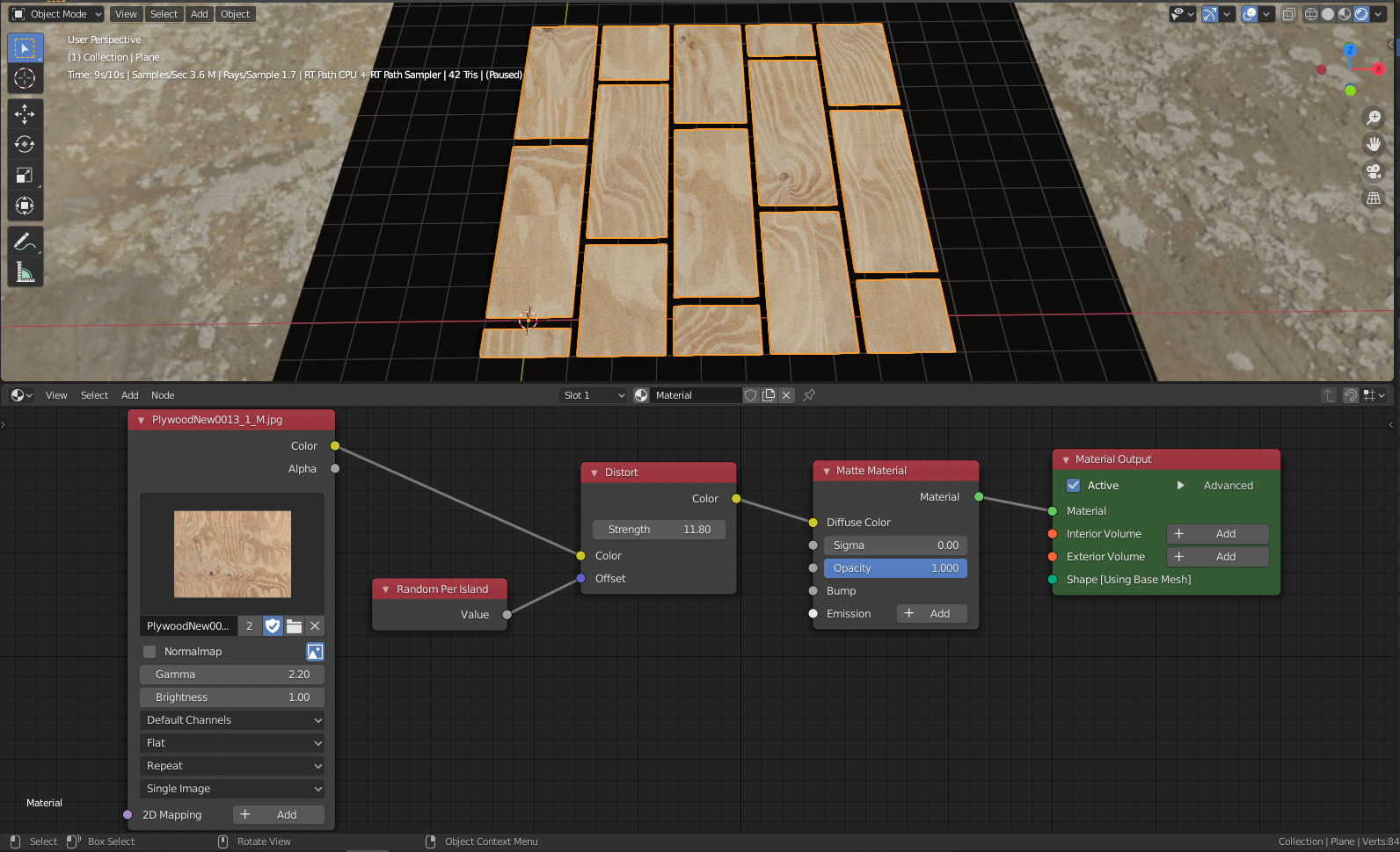

And a user on youtube ask for that one ramdom UV maps. here his comment :
Thank you! But i talk about randomization of UV maps. I know how to make it in Cycles (UV mapping node - separetae XYZ - math node -X/Y - math node +random per island - combine XYZ - texture map) but....seems it impossible in Luxcore....

Sharlybg wrote: Wed Aug 26, 2020 5:45 am Any way to randomize color in procedurale brick texture in blendluxcore ?
I think this needs to be fixed in LuxCore itself, I can look into it.
Sharlybg wrote: Wed Aug 26, 2020 5:45 am And a user on youtube ask for that one ramdom UV maps. here his comment :

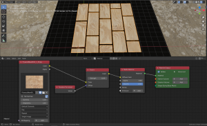

In latest builds you can do it like this:
distort_uv.blend
(775.55 KiB) Downloaded 1368 times
