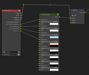

I started the work on a light group editor realized as a compositor node group.
It is created with the press of one button in the light group panel and looks like this:
(the denoise node is not yet added by the script, but it will be)
Re: BlendLuxCore Development
Look awesome and clean. ;)
Can the wide node group mixer in the middle be animated ?
So we can make light animation based on a single render shot by animating light color and strengh along a time frame.
Sharlybg wrote: Sun Jul 12, 2020 12:52 am Look awesome and clean. ;)
Yes, since it's a regular compositor node group, it can be animated.
Awesome ;)

B.Y.O.B. wrote: Sat Jul 11, 2020 10:05 pm I started the work on a light group editor realized as a compositor node group.
Hi BYBO ! Want to know if this node group is available and how enable it.
It is not done yet. It's currently only available in a branch of the addon: https://github.com/LuxCoreRender/BlendL ... oup_editor
