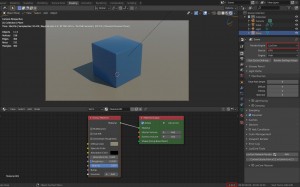

MetinSeven wrote: Tue Aug 04, 2020 7:06 pm The BlendLuxCore Preferences and the viewport render kernel precalculations only show CUDA, no OptiX. Is OptiX being used yet?
If you have the CUDA backend selected, there should be an OptiX option. If it's not there, you might not have a correct 2.5 installation? Try to delete the whole addon folder and do a fresh install of the daily build.
The user preferences should look like this:
MetinSeven wrote: Tue Aug 04, 2020 7:06 pm OptiX denoising is only available for the viewport. Will it also be available for the final rendering soon?
Yes, eventually.

Ah, thanks! I had overlooked the OptiX checkbox.

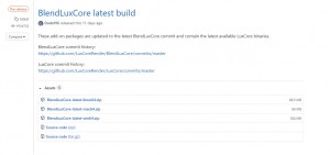

When will we have daily builds of V2.6 for Blender?
Re: LuxCoreRender daily/automatic builds
JulianoLisboa wrote: Tue Apr 20, 2021 5:47 pm When will we have daily builds of V2.6 for Blender?
They are already :?:
Post by JulianoLisboa »
Dade wrote: Tue Apr 20, 2021 6:42 pm
It appears to me as a last update 11 days ago
