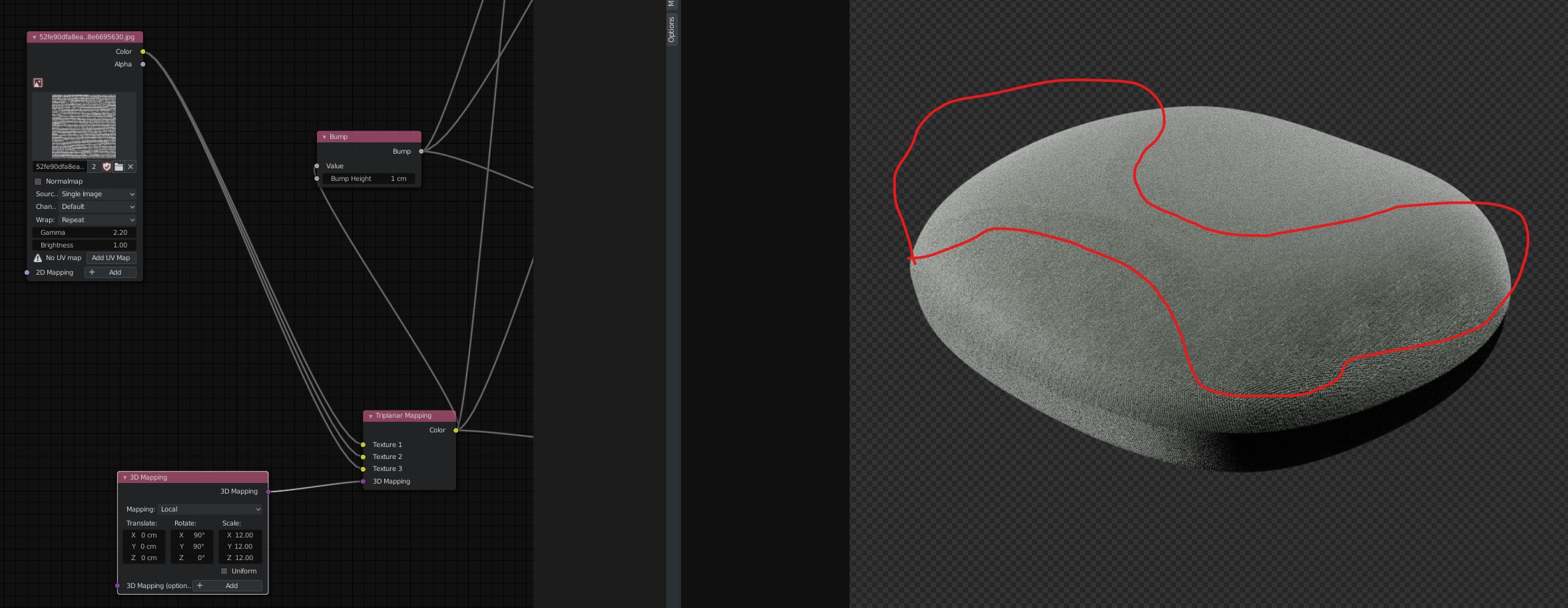

Dade wrote: Thu Jan 09, 2020 11:28 am
But first of all, LaciLaci can you post a test scene with seams so I can check if it really solves the problem ?
Yes, check this seam
in this scene
triplanar.rar
(2.59 MiB) Downloaded 619 times
Dade wrote: Thu Jan 09, 2020 11:28 am I can than expose this as an option so you have the freedom to choose if to have UVs or to use the automatic bump map support (with some limitation).
Yes please, the way I would imagine it is in blendluxcore there would be info (just like no uv warning) that triplanar is using autobump-whatever is the proper term. and a tooltip would explain it's limitations. When UV's are present then the warning isn't displayed and everything works.
HOWEVER!: this doesn't solve a problematic UV setup. For example if I start modeling from newly created cube, that has UV's in blender and start building walls from it, then Luxcore has UV's but they're all mangled up and cause trouble for shading. If this is the way it's gonna be handled, we need a good way to let user know what's the issue.
Can you identify problematic UV's? Cause I'm not sure when luxcore shading breaks for bump, is it overlapping uv's? Is it unmapped areas? Can luxcore find and autocorrect such malformed objects before render?

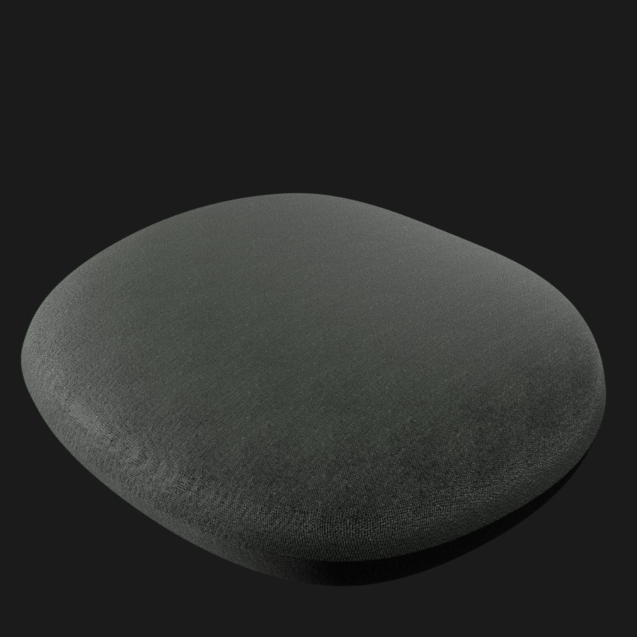

This is the original rendering:

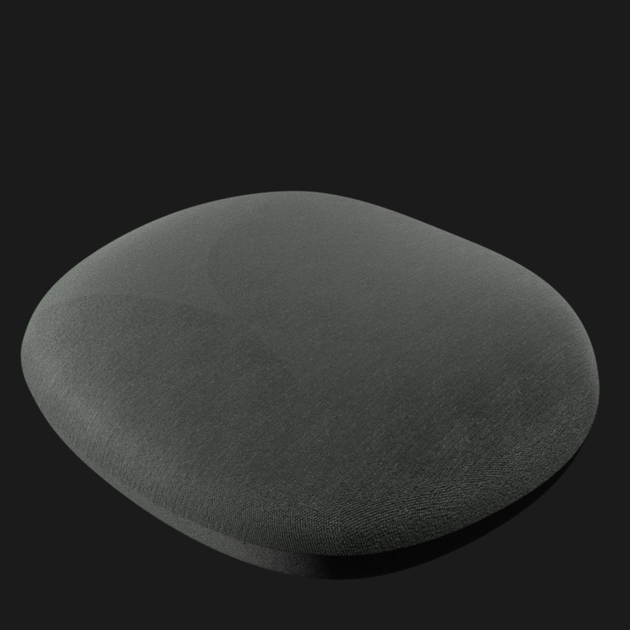

And this with the new "UV-less" method:
The bump scale is not exactly the same so the "UV-less" method looks a bit stronger (i.e. it would need to lower the scale). It seems to successful solve the seams problem. Does it looks ok ?
