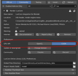

On CUDA builds, you can now choose between OpenCL and CUDA in the addon preferences.
Devices will no longer list GPUs twice.

Good. Just a question though..
Since there is now a setting that allows switching cuda/opencl does it make sense to have separate builds for opencl and cuda support?
Re: BlendLuxCore Development
The plan is to have only one build that runs everywhere in the future.

That is a nice addition.
How does it work when you have both AMD and NVIdia GPU i guest you select Opencl if you want both GPU to work and CUDA if you wann't use AMD for rendering.

Sharlybg wrote: Sun May 17, 2020 7:45 pm How does it work when you have both AMD and NVIdia GPU i guest you select Opencl if you want both GPU to work and CUDA if you wann't use AMD for rendering.
Good point, I have not taken this possibility into account. Currently you have to select OpenCL in this case, which will then be used for all devices.
B.Y.O.B. wrote: Sun May 17, 2020 8:04 pm
For the record, LuxCore is fully capable to use OpenCL and CUDA devices at the same time.
Dade wrote: Sun May 17, 2020 10:52 pm For the record, LuxCore is fully capable to use OpenCL and CUDA devices at the same time.
What I'm missing a bit is some kind of unique device ID, that would allow me to detect which devices have both OpenCL and CUDA capabilities and which don't. Currently all I can do is compare names, which are not unique.
I guess it isn't strictly necessary to have this though, since it's unlikely that Nvidia, AMD and Intel will all use the same name for some device.

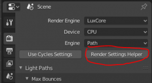

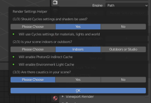

I have added an interactive render settings guide.
It asks a view questions and assings render settings based on the answers.
It is meant for newer users, to show which render settings are a good idea in which scene types.
Feedback and ideas welcome.
