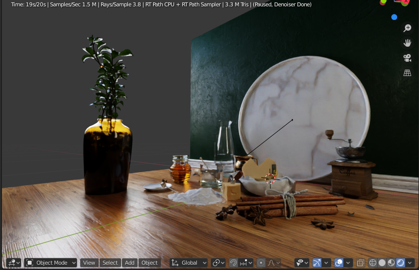

Blendluxcore don't work with blender object isolation mode Numpad key "/". It a pretty old behaviour but I though we should change it now :mrgreen:
Re: BlendLuxCore Development
I have worked on local view support a bit in a branch: https://github.com/LuxCoreRender/BlendL ... local_view
But it's ugly stuff, supporting it will make all object visibility checks slower, potentially leading to worse performance in scenes with many particles or other objects. There were also some bugs left where objects don't have the right visibility when entering/leaving local view during a viewport render.
I would like to support it, but in the current state I won't merge this patch.
