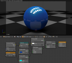

Nothing my dear i am suffering from the fact that luxcore voronoi seem a bit different :mrgreen: . And the voronoi node seem different too.
Look the voronoi cell node.

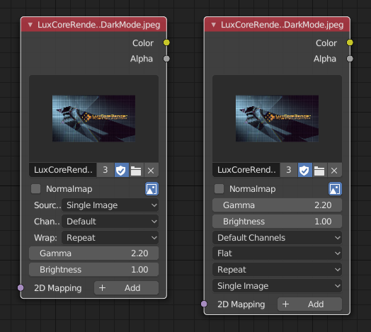

I have added a projection mode setting to the imagemap node, there is "Flat" (uses UVs) and "Box" (uses triplanar mapping).
Having this directly in the imagemap node means you don't have to use an extra triplanar node, which reduces clutter in node setups.
I also did some general UI/tooltip polishing in the imagemap node.
left old, right new

B.Y.O.B. wrote: Sun Apr 19, 2020 2:02 pm I have added a projection mode setting to the imagemap node, there is "Flat" (uses UVs) and "Box" (uses triplanar mapping).
This is awesome, but for bump we still need to use "flat" mode + triplanar bump right?
Re: BlendLuxCore Development
lacilaci wrote: Sun Apr 19, 2020 2:52 pm This is awesome, but for bump we still need to use "flat" mode + triplanar bump right?
Yes, I was considering to add a bump mode as well, but I'm not sure how often bump imagemaps are even used nowadays. Do you use them often in your projects, or rather normalmaps?
