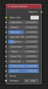

Please any possibility to display full number in node socket for value like :
100000000 or 0.00000001

Yes it has to be stated when the gui draws the property.Sharlybg wrote: Tue Jan 21, 2020 12:16 pm Please any possibility to display full number in node socket for value like :
bpy.props.FloatProperty(name="", description="", default=0.0, min=-3.402823e+38, max=3.402823e+38, soft_min=-3.402823e+38, soft_max=3.402823e+38, step=3, precision=2, options={'ANIMATABLE'}, tags={}, subtype='NONE', unit='NONE', update=None, get=None, set=None)Code: Select all
precision (int) – Maximum number of decimal digits to display, in [0, 6].so
layout.prop(self, "default_value", text=text, slider=self.slider)Code: Select all
layout.prop(self, "default_value", text=text, slider=self.slider, precision=6 )But it is a tradeoff since 1.0 would be displayed as 1.000000

For big values, you can try to make the node wider, it should help in most cases.Sharlybg wrote: Tue Jan 21, 2020 12:16 pm Please any possibility to display full number in node socket for value like :
For very small values, we need a feature in Blender to automatically show more decimal places as needed, because the way it works now, we would have to show 8 decimal places everywhere all the time. That's how it was in the old LuxBlend, and I did not like that, it makes everything hard to read:

No, you can't change the precision during UI drawing unfortunately, it has to be specified when the FloatProperty is declared. So, for example in line 180 in sockets.py: https://github.com/LuxCoreRender/BlendL ... ts.py#L180u3dreal wrote: Tue Jan 21, 2020 1:31 pm In our case this would have to be added to sockets.py in line 32 if i understand right.

But after 0.001 the last number is always invisible no matter how wide the node is.
Re: BlendLuxCore Development
Yes, making the node wider only works for big numbers, not small ones.Sharlybg wrote: Tue Jan 21, 2020 1:38 pm But after 0.001 the last number is always invisible no matter how wide the node is.
I have now pushed a commit that changes the UI precision from 2 to 3 decimal places for node sockets (same as Cycles uses).
