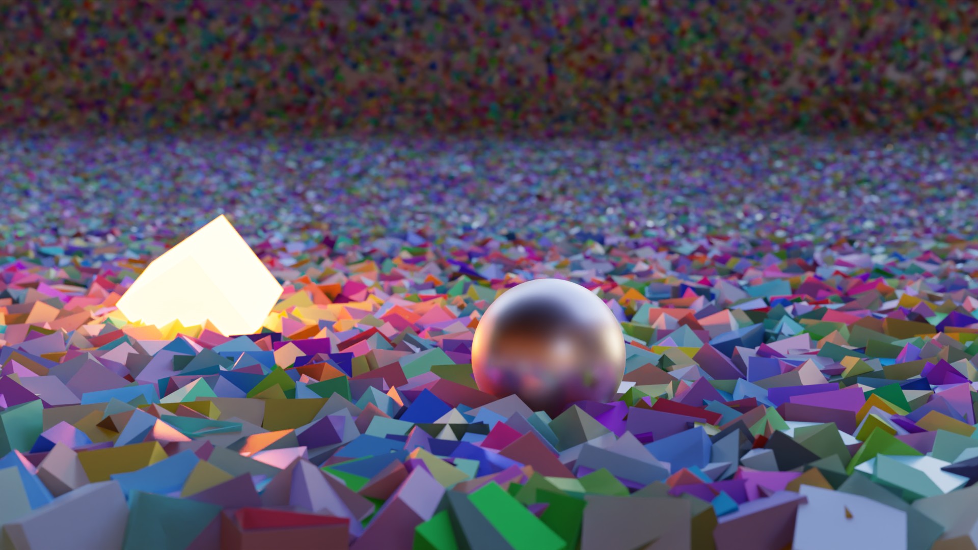

In the course of the 2.8 port of the addon, the dupli export got swept under the rug a bit (it got a lot slower).
Now I have pushed a first commit of the work on faster instance export.
Some stuff is currently broken, for example moving an instanced object in the viewport will cause it to be re-exported and appear duplicated during the rest of the viewport render session. Also, hair on duplis is not yet exported. If you find anything else, please report.
Here's a scene with 20,000 instances distributed via particles.
Old export time: 7.6 sec
New export time: 0.7 sec
(export time without instances is 0.1 sec)
Re: BlendLuxCore Development
1 million instances around 26 seconds
Great work!
Great work!
Btw, this new implementation doesn't stop at particles, it applies to almost all kinds of duplis/instances: dupliverts/faces, particles, collection instances etc., only objects with shared meshes (alt+D copies) are not accelerated by it.
So it doesn't matter if you put 10,000 chairs in a room via particles or via collection instances, they should both export in the same time.
